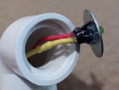

- Prepare the washer. If your 1-inch-wide washer doesn't have a 5/16-inch hole in it, then use a drill to widen the hole. (5/16-inch is a good fit for the 8mm LED holder.) If you'd like, you can paint the washer black, to help your LED stand out.
- Place the LED into the LED holder.
- Snap the LED holder into the washer.
- Solder the resistor to the LED's negative terminal -- that's the short wire. (Depending on the length of your resistor and LED, you may want to trim the wires so that the whole LED-and-resistor assembly will be less than 2 inches / 5 cm long.)
- Solder a short length of black wire to the resistor. (About an inch or two should be enough.)
- Solder a short length of red wire to the LED's positive terminal -- that's the longer of its two "legs."

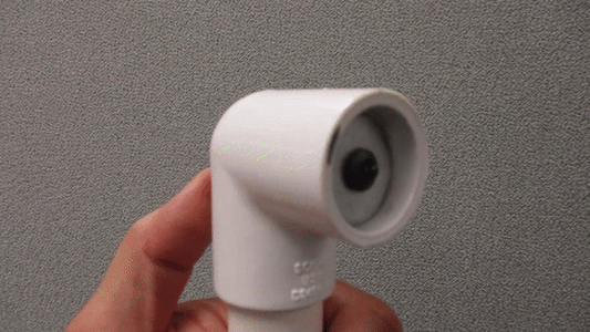

Step 4: Attach the Lamp Assembly

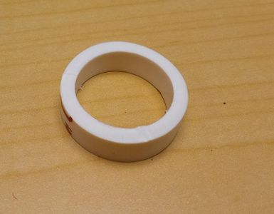

- Cut a small ring from a length of the 3/4-inch plastic pipe. I found that a length of about 1/4-inch worked well, but the exact size isn't important. (A plastic-pipe cutting tool is a great asset here, since it doesn't create sawdust!)
- Press the ring into one end of the elbow.
- Slide the lamp assembly into the elbow, so that the washer sits up against the ring. When you're satisfied with the fit, glue to washer to the ring. (I found that super glue was much more kid-resistant that hot-melt glue.)
- Solder one of the black wires from the switch to the black (negative) wire from the lamp assembly. Insulate the connection with either heat-shrink tubing or electrical tape.
The "head" of the flash light now has two loose wires emerging from it: a red wire from the lamp assembly, and a black wire from the switch. Ready for the next step!
