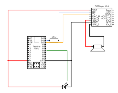

Solder three male-male wires to Neopixel matrix
Wire the components according to following figure.
