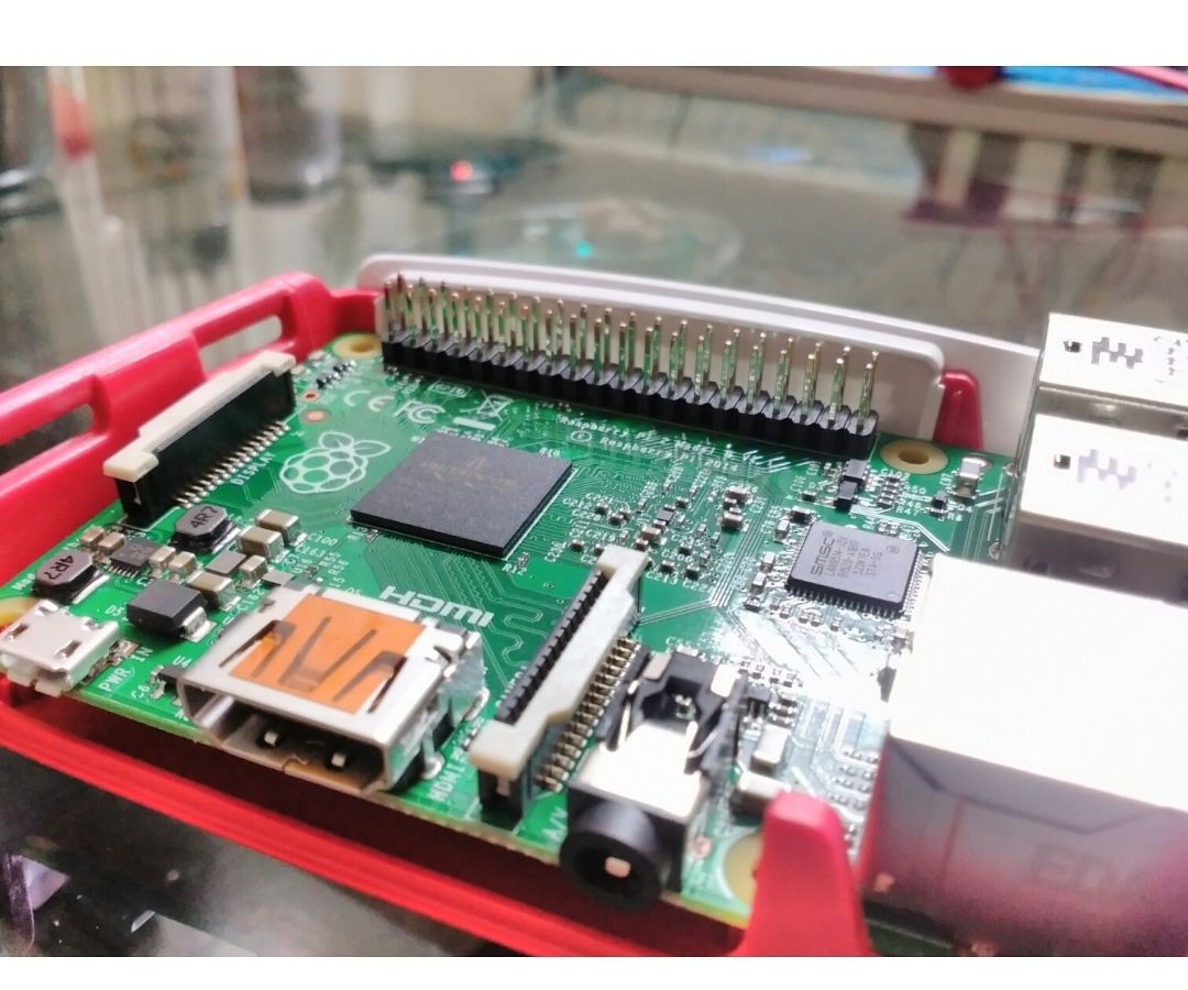

Introduction: A Bash Program to Generate Voice Output of Local Time on Raspberry Pi
Hey netizens! This is the first Instructable I've made! This site has helped me immensely as a student, learning to DIY. I want to help this site in return.
Now, for the details, this is a simple talking clock that says the day, date, month, time and year in English using the picoTTS. A TTS is a text to speech converter and is a nifty little tool that can go well with a wide range of projects. There are more TTS softwares like eSpeak and Festival but I found pico to be the best.

Step 6: Making a Clock
If you type date, into the command line it will give you the date. I used this function to create an executable shell script.
Type nano talking_clock.sh, paste the following code and press Ctrl+o, Ctrl+x.
CODE -
#!/bin/bash
while : do
pico2wave -w test.wav "Today is $(date +%A) $(date +%d) $(date +%B) $(date +%Y). The time is $(date +%l) $(date +%M) $(date +%p) $(date +%Z)"
aplay test.wav
sleep 60
done
