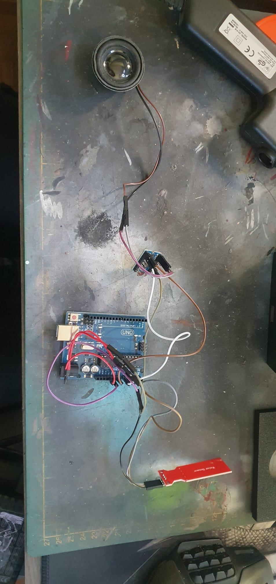

Step 1: Wiring the Components
Connecting the Water Sensor
  1. VCC → Arduino 5V
  2. GND → Arduino GND
  3. Signal Pin → Arduino A1
Connecting the DFPlayer Mini and Speaker
  1. VCC → Arduino 5V
  3. RX → Arduino TX (Pin 10)
  4. TX → Arduino RX (Pin 11)
  5. SPK1 & SPK2 → Speaker
Use jumper wires for secure connections and avoid loose wiring that may cause issues.

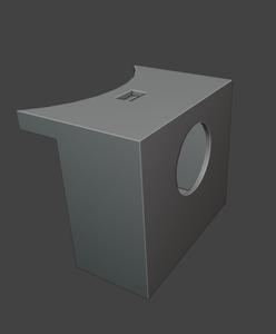

Step 3: Designing the 3D Printed Housing
Before jumping into the 3D modeling, I took some measurements and planned out the design to ensure everything would fit neatly and function as intended.
Measurements and Design Considerations:
  1. Full Box Dimensions – The overall box was designed to be 10x9 cm.
  2. Speaker Size – The speaker has a 4 cm diameter, so I made sure there was enough room for it.
  3. Power/USB Input – The power and USB input port was located on the bottom of the box at coordinates (1 cm, 1.5 cm, 3 cm) relative to the Arduino. The input port is 1x1.5 cm in size.
  4. Depth – The box was designed to be 4 cm deep to ensure there was enough room for the cables and other components.

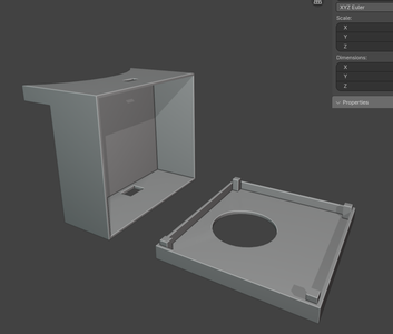

  5. Cap Design – I sliced the box vertically to create the cap, and included four 0.5x0.5 cm cubes at each corner to secure the cap in place, preventing it from shifting.
  6. Mounting Feature – To make it easier to mount the box onto any flowerpot, I created an overhang of 2.5 cm at the top back of the box.
  7. Water Sensor Cable Hole – A 0.5x1 cm hole was created at the top of the box to allow the water sensor cables to pass through easily.

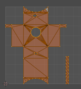

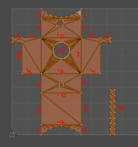

With these measurements in mind, I used Blender to model the box and all its components. The design was aimed at making sure the electronics would fit snugly inside, while also keeping everything accessible and easy to mount.
Assembly Notes:
  1. After printing the parts, I used hot glue to secure the components inside the box and to hold the speaker in place within the cutout. This ensures everything stays stable and that the sound comes through clearly.
  2. The cap with its four corner cubes creates a reliable locking mechanism, making it easy to open and close the box while ensuring everything stays in place.
