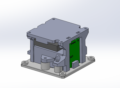

Step 1: Design
- The basis for this project is a sound module (DY-SV5W), tilt switch and speaker.
- It uses a small lithium-ion battery, charging board and a voltage boost module to get to 5v for the sound module.

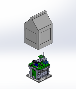

- The electronics assemble onto a "skid" and then are inserted into the milk jug housing.
- I'm sure this could have been built several different ways.
- My goal was to do this with off the shelf components, while trying to keep it simple.
- Tilt switch - This a simple switch that is triggered by turning it a certain angle. It's a lo-fi way of not needing to use an IMU or microcontroller.
- Sound module (DY-SV5W) - this is a low cost sound module, which can store and play mp3 files. It's fairly small and can drive a 5w speaker.
Step 2: Build
- 3d print all the files

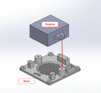

- Screw the speaker into the base.
- Double-side tape the battery onto the back of the speaker.
- Screw the inner frame onto the base.
- The charging board is held in place between the inner frame and the base.

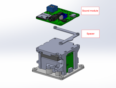

- Screw the sound module onto the inner frame (with the spacer in between).

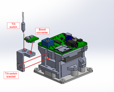

- Put the tilt switch into the tilt switch bracket and screw the bracket into the inner frame.

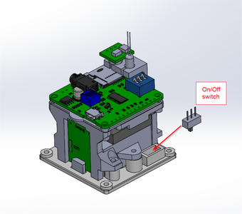

- Put the on/off switch into the base and secure it with a dab of E6000 glue.

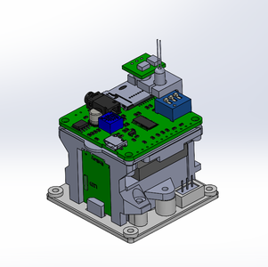

- Solder everything together!
