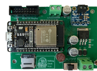

Step 1: Completing the PCB
I had my PCB produced by PCBWay, they offer great service at a good price. You can buy the PCB at my Tindie store Most components are included. You only have to solder on the ESP32 devkit, the I2s Audioboard. I highly recommend that you don't solder the EPS32 board directly onto the pcb. Use single Row headers or a socket instead! That way, you can always remove the ESP32 if needed.
Make sure you place the ESP32 in the correct orientation. See photo for example.
