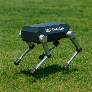

In recent years, the MIT Mini Cheetah has become a hallmark of small-scale, high-power-density, and hackable quadruped platforms—bringing legged robotics from academic papers to real-world experiments. It can perform backflips, run fast over grass and gravel, and handle unstructured terrain with remarkable agility.
However, before you can “tame” an entire cheetah, the most pragmatic starting point is — getting one leg to behave.
This demo represents a classic “single-leg first” approach: using Python to control brushless actuators via CAN bus, implementing joint-space trajectory and impedance control, and showcasing basic motion primitives.
