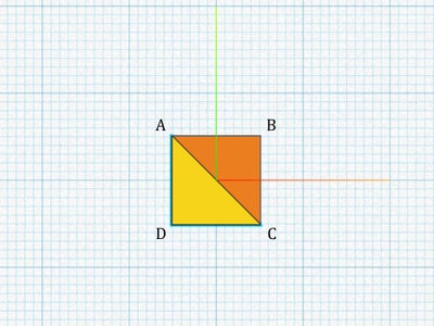

Now, we start with a square, and its side length is 10. Then, make a triangle, but there are only two shape blocks - roof and wedge - in the toolbar. Maybe they're not the triangles you want because you want to modify their side lengths or something. So, what should we do?
Step 3: Make an Isosceles Right Triangle

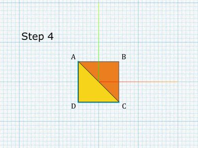

This is not an ideal way to make different triangles. But when making an isosceles right triangle △ACD in step 4, it may be a better approach. We use the overlapping method to cut the square ABCD in step 1 into an isosceles right triangle △ACD in step 4. Yes, we need to do it one more time to get another isosceles right triangle △ABC.
In step 3, it is recommended to make a transparent square HIJK with sides equal to the hypotenuse HK of the triangle △ACD, so the distance the square HIJK moves is equal to half the length of its side. Here, the Pythagorean theorem is used to calculate the hypotenuse HK. (You may use other shapes to cut the square ABCD in step 1, but you need to pay attention to the distance the shape moves.)

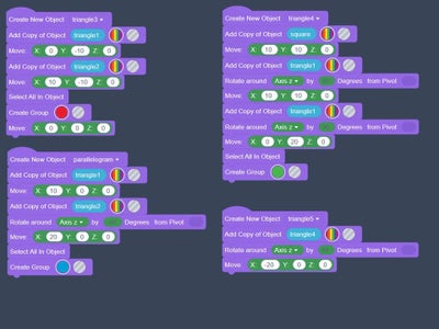

Step 4: Make a Tangram
It is believed that students have created the isosceles right triangle, and then they can make a tangram by using Copy, Rotate, Move and Create Group in toolbar. Have Fun!

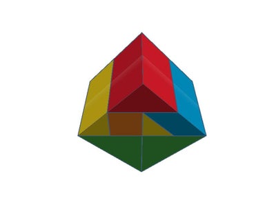

Step 6: Next, Make a 3D Tangram
You've got the tangram coding. Why not making a 3-dimentioanal tangram? You just have to modify the height to make a 3D tangram. It can help students learn 3D shapes and develop sense of space and orientation. You can go to my Instructableto get more information about making 2D and 3D Tangrams using origami and cardboard. Have Fun!
Step 7: Code Example for Tangram
Step 8: Code Example for 3D Tangram
