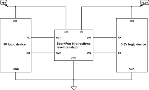

A 3.3v to 5v logic shifter (Only if your 2 boards work on different voltages)

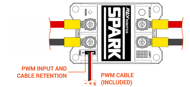

2 motor controllers (We used Sparks by CTRE but you can use any that supports PWM)

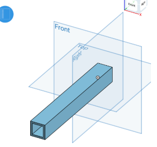

Our initial step was to utilize Onshape, a 3D CAD program that allows for online part design accessible at any time. Onshape also provides the ability to generate G&M codes for CNC machining, facilitating precise fabrication of parts.
However, due to limited resources, we opted to manually fabricate the parts using traditional tools, including bandsaws, drills, belt sanders, hammers, and drill and tap sets. These basic tools allowed us to shape and assemble the components necessary for our robot.

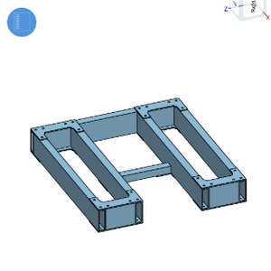

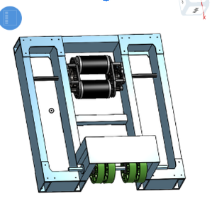

Step 3: Designing the Frame
We began by designing the frame, following several brainstorming sessions over a few days where we explored different iterations. Ultimately, we settled on a square frame with two sets of wheels, totaling four. The wheels are secured using ten brackets, all of which we hand-manufactured.

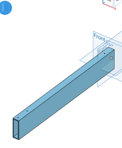

Step 4: Designing the Parts

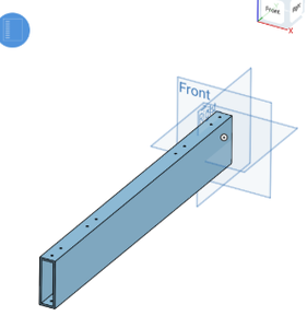

The first part we fabricated was the back of the frame, a 20-inch-long piece of 1” x 3” x 0.125” aluminum rectangular tube. We cut 16 holes in this piece to prepare for riveting the frame together. The type of rivets and the size of the holes can vary depending on the rivets you choose to use.
The next part we designed was a 21-inch piece of the same 1” x 3” x 0.125” aluminum rectangular tubing. This part needs to be manufactured four times, as it serves as each of the extrusions connecting to the back of the frame. We cut six holes in each piece to prepare for riveting the frame together. The type of rivets and the size of the holes can vary depending on the rivets you choose to use.
The last major part of the frame we made was a small block to connect each of the previously made parts together, forming sections that provide the structure for our wheels. This extrusion is a 4-inch piece of the same 1” x 3” x 0.125” aluminum rectangular tubing. As with the previous steps, we cut four holes to prepare for riveting the frame together. The type of rivets and the size of the holes can vary depending on the rivets you choose to use.
To help support the frame and prevent warping in the drivetrain, we added a simple piece of 1” x 1” x 0.125” aluminum square stock. This extrusion is 1 inch long and will also be riveted into the frame. Follow the same steps as before to create the necessary holes in preparation for the riveting process.

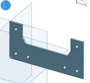

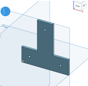

Step 5: Creating the Brackets
We now need to manufacture 8 of these brackets to hold the frame together after inserting the rivets. To make each plate, you will need a 6” x 24” piece of 0.125” thick aluminum. (We recommend getting extra material to account for any mistakes and the material lost due to the saw blade.) Each plate should be approximately 6” x 3”, with a section cut out in the center to provide space for the wheels that will rest inside the drivetrain. The ends of the plate should be 1 inch thick to ensure it lays flush on the frame. Afterward, mark the holes for drilling based on the holes you created in the base frame earlier. The more precise you are with your markings and measurements, the more square your frame will be, helping to avoid gaps.
This small, simple bracket is located at the bottom of the frame, holding the support bar in place to prevent it from falling out or warping. To manufacture this part, you'll need an additional 6” x 3” section of 0.125” aluminum. From this, you'll cut out a 3” x 3” square and shape it into a T, making each fork 1 inch wide. Drill the holes accordingly to fit your needs, following the steps described previously above.
Step 6: Assembling the Frame
1. Assembling the Back of the Frame:
•Start with the 20-inch-long piece of 1” x 3” x 0.125” aluminum rectangular tube.
•Ensure that the 16 pre-drilled holes are aligned correctly for the riveting process.
•Place the 20-inch piece flat on your workspace as it forms the back of the frame.
2. Attaching the Side Extrusions:
•Take the four 21-inch pieces of 1” x 3” x 0.125” aluminum rectangular tubing.
•Align each piece perpendicularly to the 20-inch back piece, with the holes on each 21-inch piece matching the corresponding holes on the back.
•Rivet each 21-inch piece to the back frame, securing the frame's sides.
3. Connecting the Side and Back with Small Blocks:
•Use the four 4-inch pieces of 1” x 3” x 0.125” aluminum rectangular tubing as connecting blocks.
•Place each 4-inch block at the joints where the 21-inch pieces meet the 20-inch back frame, ensuring proper alignment.
•Rivet these blocks in place to secure the corners and reinforce the frame structure.
4. Adding the Support Bar:
•Take the 1-inch-long piece of 1” x 1” x 0.125” aluminum square stock.
•Position it in the middle of the frame to prevent warping in the drivetrain.
•Drill holes as needed and rivet this support bar into place.
5. Fabricating and Attaching the Brackets:
•Cut eight brackets from a 6” x 24” piece of 0.125” thick aluminum, each measuring 6” x 3”.
•Cut out a section in the center of each bracket to provide space for the wheels.
•The ends of the bracket should be 1 inch thick to ensure a flush fit on the frame.
•Drill holes in the brackets to align with the frame’s existing holes.
•Attach the brackets to the frame with rivets, ensuring a snug and secure fit.
6. Installing the Bottom Support Bracket:
•Cut a 3” x 3” square from a 6” x 3” section of 0.125” aluminum.
•Shape the square into a T, with each fork being 1 inch wide.
•Drill holes in the T-shaped bracket to align with the frame's bottom section.
•Rivet the T-bracket in place to secure the support bar and prevent it from falling out or warping.
By following these steps, you will have a strong and well-aligned frame ready for the next stages of your project.

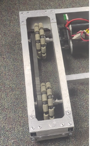

Step 8: Adjustable Wheel Tension System
3. Adjustable Wheel Tension System:
Description: The system you're referring to allows the tension of the wheels to be adjusted by tightening or loosening screws at the front of the mechanism.
How It Works:
Screws at the Front: These screws are connected to a mechanism that either tightens or loosens the grip on the wheels.
Tightening the Wheels: When you screw in, it pulls the components together, increasing the tension on the wheels. This can improve grip and reduce wobble, especially useful for maintaining traction on different surfaces.
Loosening the Wheels: Unscrewing releases the tension, allowing the wheels to spin more freely. This adjustment can be beneficial in situations where less grip is required for smooth, uninterrupted movement.
Benefits: This system provides flexibility to fine-tune the robot’s performance based on the field conditions or specific tasks during a competition.
By understanding these concepts—gear ratios for power and speed management, omni wheels for enhanced movement, and the adjustable wheel tension system for maintaining optimal grip—you can optimize your robot for better performance in various scenarios.
In these 2 photos you can see the omni-wheels and our belt tension system. The belt tension system was made because we were having issues with our belts being loose so we made a threaded rod connected to an insert inside the frame that comes out the front to a plate that we tightened a nut onto.

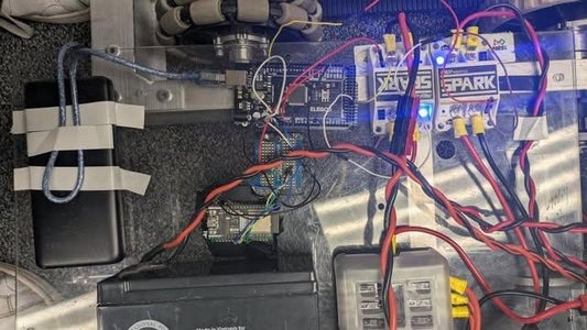

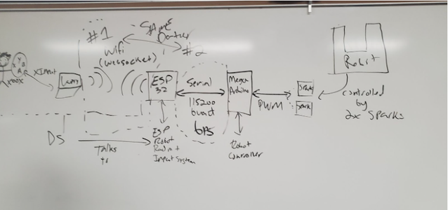

Step 11: Getting Started on the Programming
The first thing that we have to do for the programming side is think about the way we handle it:
As you can see, we spent a lot of time brainstorming to program this in an effective manner the steps we ended doing were:
Wirelessly connect an xbox controller to the Laptop
Put the relevant controller inputs into a struct, and send it over to the wifi module (esp32) on the robot via websocket communication.
Send the struct over to the Arduino mega via serial communication
Set the motors to the desired value based on the controller input
However, at the time of writing, there weren't any software that were capable of doing this specific task, so I (Shyamak) had to make my own software capable of doing this.

The Arduino side was in 2 parts: the ESP32 and the Arduino Mega. The ESP32 would receive the WebSocket signals using the ArduinoWebsockets library, decode it and send it over the to Arduino Mega. This method provides for there to be more outputs later on, as the Arduino Mega has more PWM output ports than the ESP32-WROOM-32E. This is the code for the ESP32:

Step 16: Using a Logic Shifter
While the code for communicating between the 2 boards using serial is functional, there still remains one hurdle: the voltages don't match up. You see, the ESP32-WROOM-32E natively runs at 3.3V, while the Arduino Mega runs on 5V. Because of this, the two devices can't communicate to each other as their voltages don't match up. The solution to this is a logic shifter, a small device that, as the name suggests, shifts the voltage between the 2 devices so that they can communicate with each other. The pinout can be seen in the image above, and we connect the ports from the corresponding PCBs to each other on a breadboard. Keep in mind the RX and TX pins on the esp32 are 16 and 17 respectively.

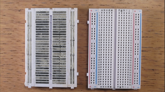

Step 17: How a Breadboard Works
A breadboard is a device that allows people to quickly wire up electronics by providing an array of holes, which people can stick DuPont wires into. This allows people to make more complex creations by being able to visualize what they're building, along with saving the hassle of plugging things directly into sockets. The slots on the outside (marked light blue on the picture) are generally used for power, while the ones on the inside can only travel horizontally. Another way to understand it would be to look at the copper wires on the other side of the breadboard in the picture on the right, and how currents can only travel through those copper panels.

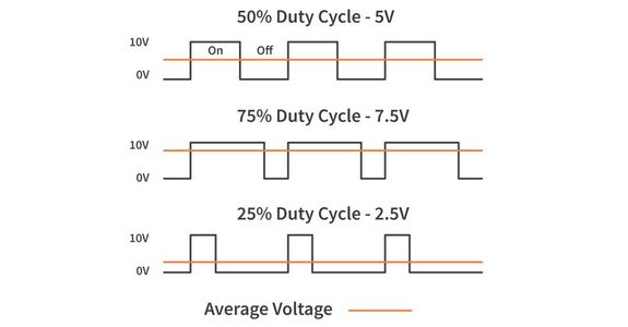

Step 18: How PWM Works
PWM is short for Pulse Width Modification, and is a method that is used for older motors. Rather than lowering the voltages of motors, sacrificing torque, we can instead use PWM which saves the torque of the motor. The way PWM works is by having the motor at 2 states: 100% power and 0% power, or ON and OFF. The way that it lowers the speed of the motor, however, is by tweaking the how long its on and how long its off. For example, if the motor is running at 100%, the motor stays ON constantly, and vice versa if its on 0% power. But if the motor is at 50% power, then the motor stays ON and OFF for the same amount of time, with the motor turning itself ON and OFF extremely quickly, as in multiple times per second. The amount the motor stays ON and OFF changes based on the percentage, so if it's at 70%, the motor is ON more than its OFF, and vice versa if the motor is at 30%. Arduino uses the AnalogWrite() function for PWM output, with 127 being neutral, 256 being 100% forwards, and 0 being 100% backwards.
Step 19: Using Motor Controllers
To use the motor controllers, we had to wire them up according to the image above. The incoming voltage was the one that came from the PDH (linked at the top of the page in supplies needed), with the signal, ground, and voltage wires coming from the Arduino Mega. Keep in mind that the Arduino Mega only has a certain number of pins that support PWM output, with the specific pins being listed online.

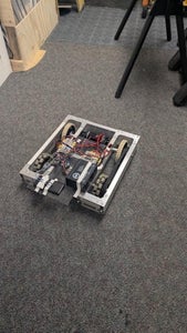

Step 20: Final Step
The last step is to wire everything together. We put a plexiglass panel on our robot where we housed all our electronics. Our 12v battery was wired to our PDH, which had two motor controllers wired to that. These were wired to the Arduino Mega via the pinout provided in earlier steps. You will also need a power bank to for the PCBs, and you can just connect it to any one of the PCBs via USB as the one thats powered powers the other. For reference see the image attached to this step. Congratulations! You've just made a state-of-the-art robot.
