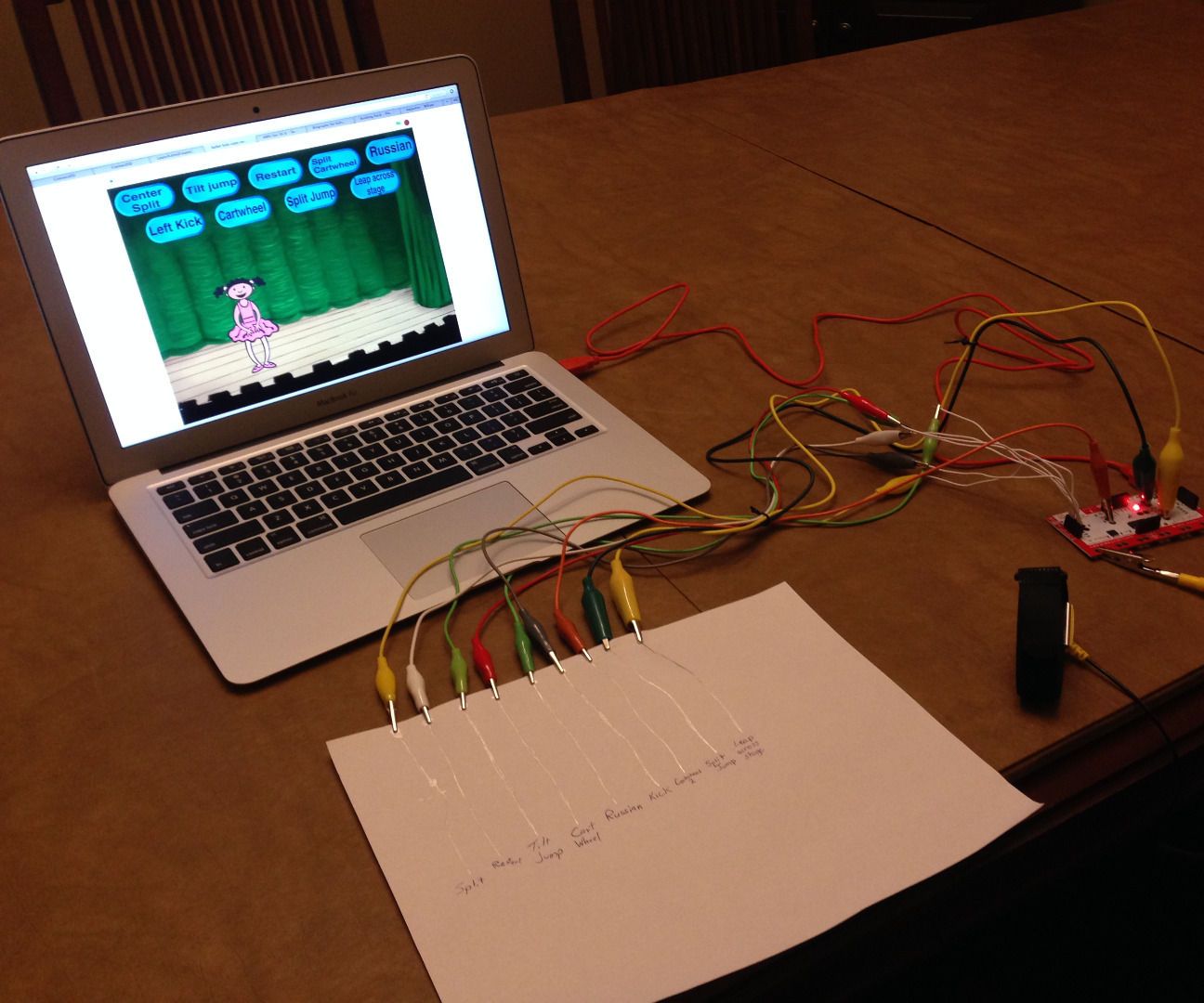

Step 11: Making Tap Pads
To make the "tap pads", you need a piece of paper - cardstock works best - and a CircuitScribe Conductive Ink Pen. You draw arrows with the conductive pen, and then draw lines from the arrows to one side of the paper; I chose the top. If you want to add another robotic action, do the same with a rectangle, labeled underneath "Space". It should look somewhat like the example drawn below - with four arrows and a space bar. Later, you can add more to the code and create more features if you want them.
Step 12: Assemble the Circuit
To assemble the circuit, you need the paper that you just created, a Makey Makey tool, and a computer. First connect the colorful wires to the paper so that they're touching the conductive ink...
... then connect them to the corresponding holes in the board.
Connect the long orange cable to the circuit board and to the USB port on the computer.
Then connect a wire to one of the ground holes on the Makey Makey. (If you want to, you can use Antistatic Wrist Strap, so it holds you, instead of you holding it.)
If you need more assistance with the Makey Makey, see our first Instructable Using CircuitScribe, Makey Makey, and Scratch to Create Art.
