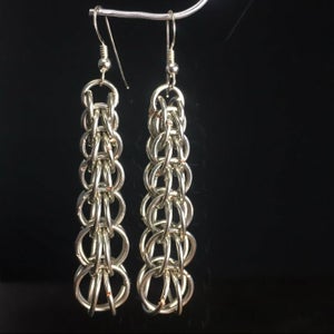

Introduction: Tapered Chain Earrings
Hello and thanks for checking out my instructable. I've had quite a bit of positive feedback on my other recent chainmail instructables, so I wanted to share another cool pattern and project idea with you.
In this tutorial, I'm going to teach you to make tapered chainmail earrings using the full Persian weave. This pattern is definitely a bit challenging to learn, so before you try to do the earrings you might find it valuable to first make a small length of chain just to get the hang of it.

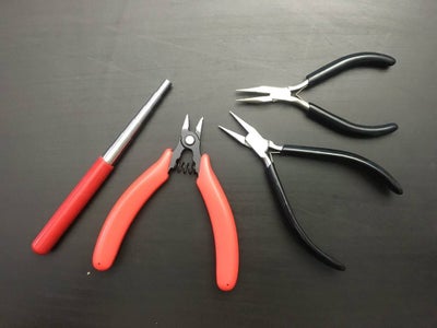

Step 1: Tools and Materials

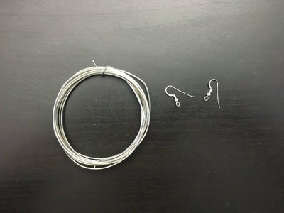

The tools and materials you'll need for this project are:
- Wire - I'm using 16 gauge 'artist wire' from Michaels, but if you want to make a smaller pair of earrings try 18 gauge instead
- Ear hooks
- A stepped mandrel - mine ranges from approximately 7/16" to 3/16" with 6 steps. The earrings are definitely on the large side of things, using 18 gauge wire and slightly smaller mandrel would yield a pair of earrings that would be more casual.
- Side cutters
- 2 pairs of toothless pliers

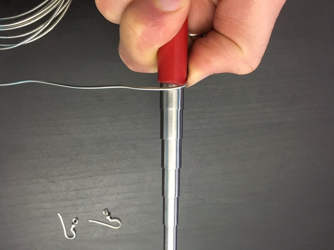

Start by holding an end of the wire tightly the mandrel with your thumb. (Photo 1)
Coil the wire tightly around each step of the mandrel. Try and get 5 or 6 coils around each step. You could also do each step separately if you are finding it difficult. (Photos 2-4)

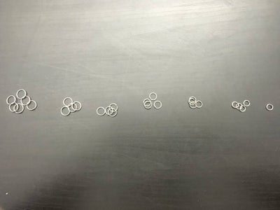

Once all the rings are cut, you'll need 6 of the largest rings, 5 of the smallest rings, and 4 of all the intermediate sizes of rings. (Photo 10)

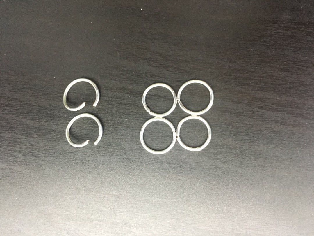

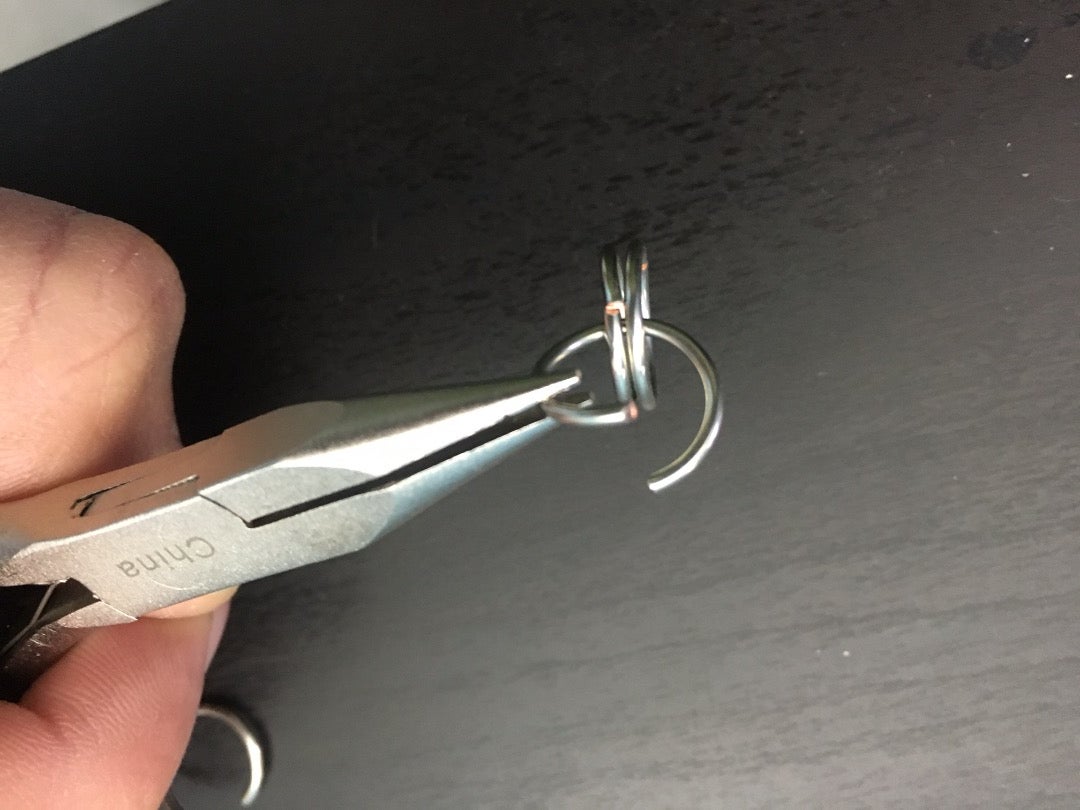

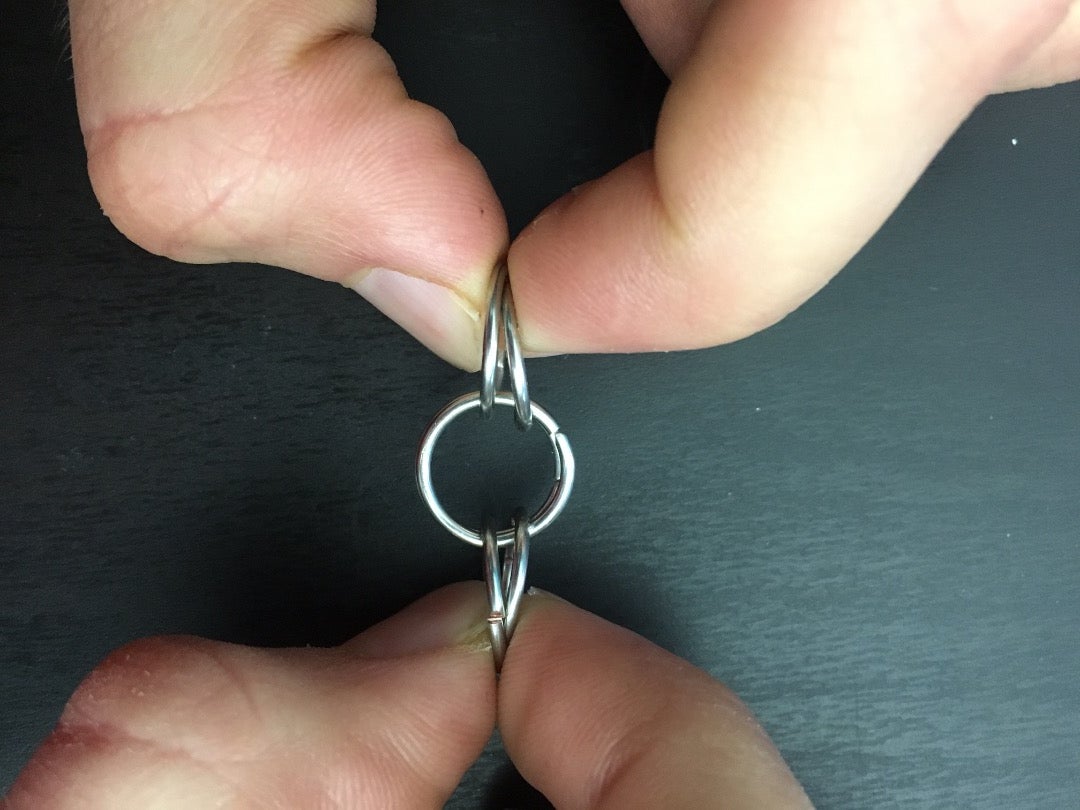

Start off by closing 4 of the 6 largest rings and opening the other two. If you've worked with store bought rings before, they are easier to open and close because they are saw cut. When you cut the rings with snips, they tend to get deformed slightly and you have to bend them back and fourth a bit to get them to flush up when you close them. (Photo 1)

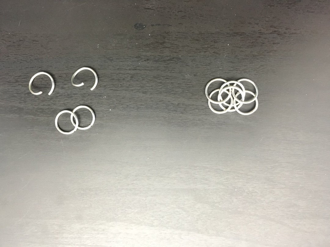

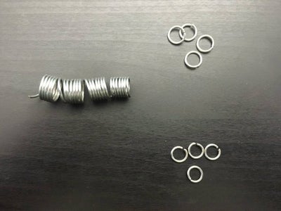

Put the 4 closed rings on the 2 open rings and close them. This'll give you a 2-2-2 chain. (Photo 2)
Next, get the next size down of rings ready. Close 2 of them and open 2 of them. (Photo 3)
Hold the ends of the 2-2-2 chain... (Photo 4)

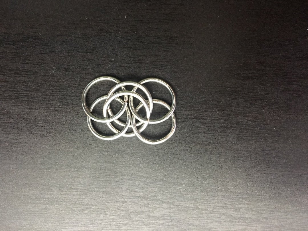

And open the rings on the right and push the rings in-between them. (Photo 5)

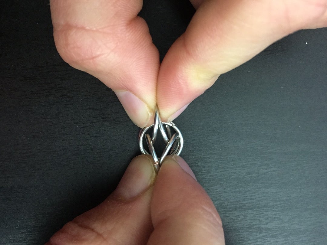

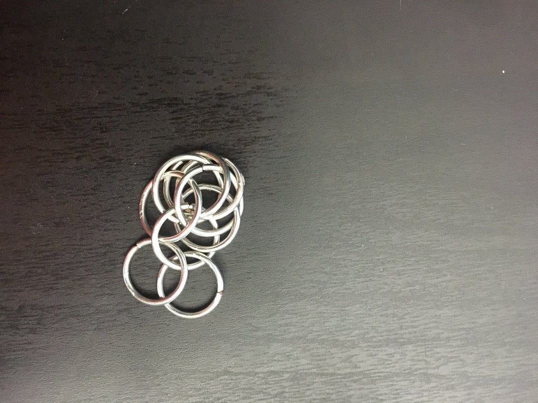

This is the tricky part: while maintaining the ring configuration you just created, take one of the open smaller rings with 2 closed smaller rings on it (Photo 6) and put it between the centre rings of the 2-2-2 chain and through all the end rings, holding them in place. (Photo 7)
Put the other open ring through all 6 rings the exact same way. (Photo 8)

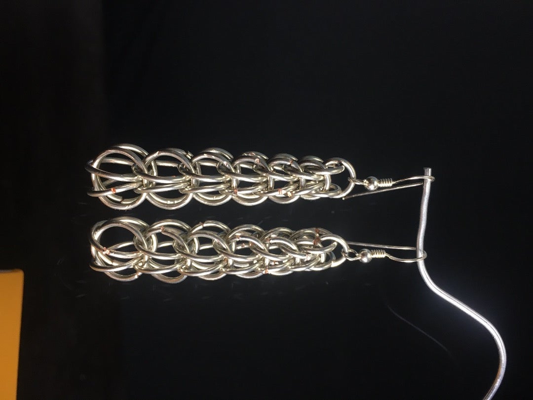

Follow the photos and captions to continue the pattern using progressively smaller rings for each step. At this point, you've got past the hard part .
Step 5: You're Done!
Once you've made a first earring, make a second one the same way. You can also use these as a pendant or decoration. Thanks for checking out my intractable and please let me know if you have any questions.
