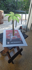

With Unity and Vuforia, we'll build an Augmented Reality application for Android phones. The application will show the user camera and add virtual 3D model to a target printed beforehand.

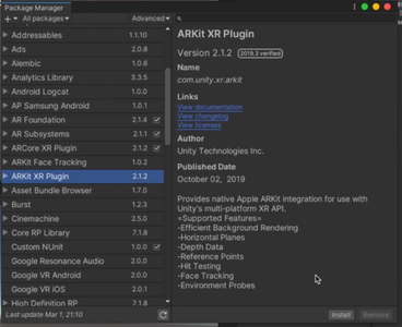

Once you added one to your account, you can go back to Unity and open the Package Manager in the Window Menu. Select My Assets, download and import it.

You'll now have an apk file that you can install on your Android and try it out!
