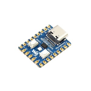

  • Microcontroller more powerful than an Arduino UNO (Not enough ram) I used a "Waveshare rp2040-zero" from AliExpress

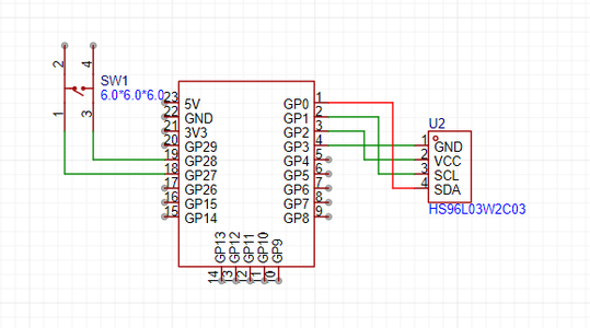

  • SSD1306 OLED display connected to appropriate pins on microcontroller.
  • Optional button from any digital pin to gnd (I used a digital output to supply ground).

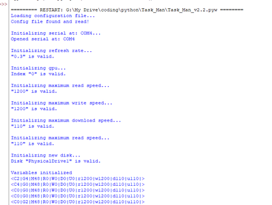

  13. Line 8: Disk name (Usually PhysicalDrive0) or 'ALL' in order to take the sum of all disk activity. Use psutil.disk_io_counters(perdisk=True) in the IDLE shell to decide on a disk if not using 'ALL'.
  14. Now run the program, you should see the data in the shell, and also on the OLED screen.

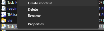

  28. Create a shortcut to the .pyw/.exe file
  29. Place this shortcut in %AppData%\Microsoft\Windows\Start Menu\Programs\Startup

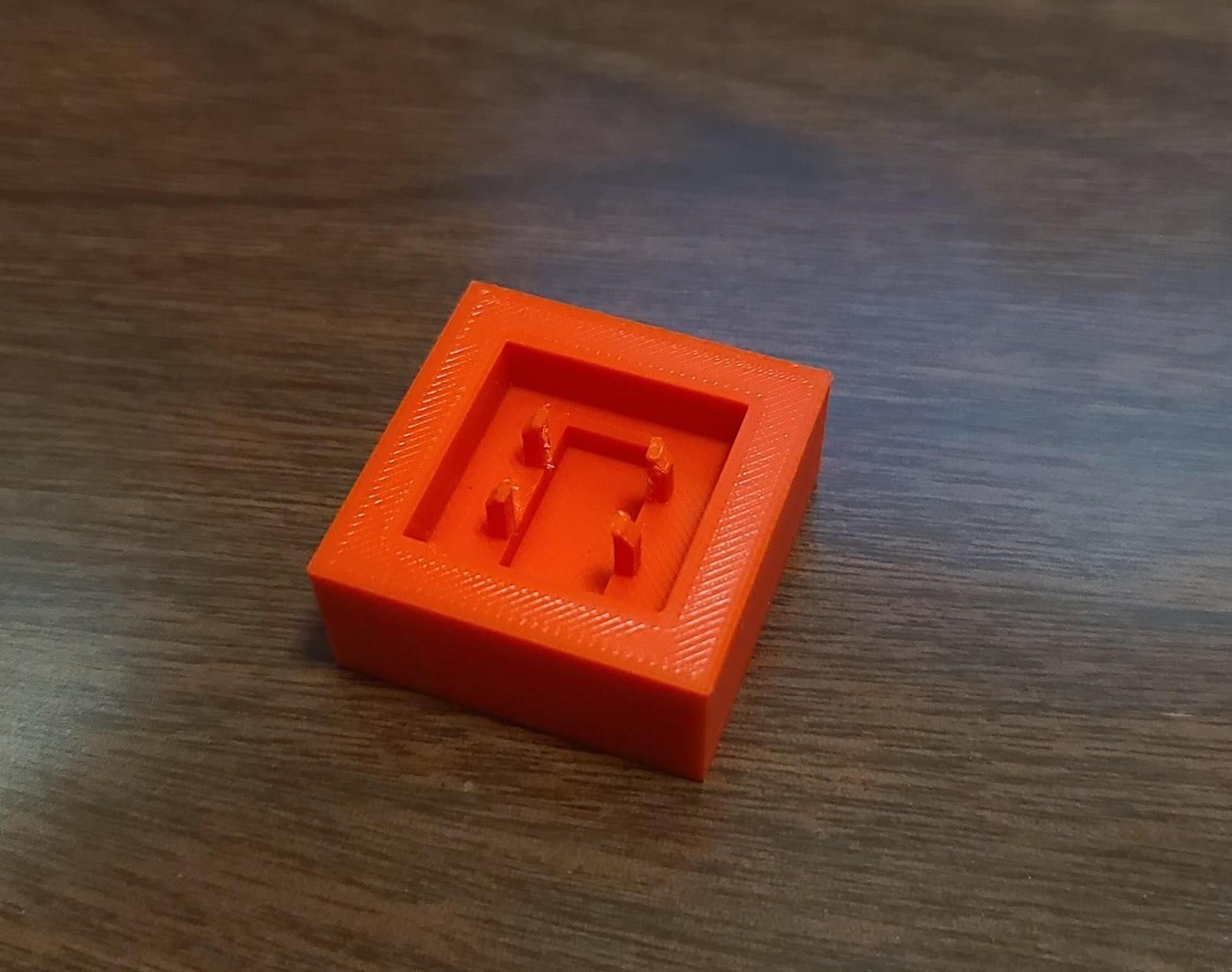

  • I unfortunately do not have the plans for my original CNC milled wooden enclosure. You will have to design and create your own case.
