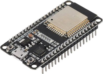

  1. ESP32 Dev-board

  1. ESP32 Dev-board – Central controller; power it via USB.

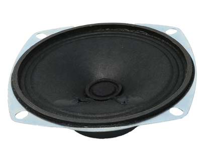

  2. I2S Amplifier + Speaker – Connect to ESP32 I2S pins and 5V power.

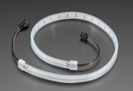

  3. NeoPixel LED Strip – Connect DIN to a digital GPIO (e.g., GPIO21), 5V and GND.
