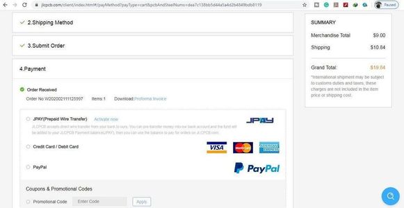

Step 7: Select Shipping Address and Payment Mode
6. Type the Shipping Address.
7. Select the Shipping Method suitable for you.
8. Submit the order and proceed with the payment. You can also track your order from JLCPCB.com.
My PCBs took 2 days to get manufactured and arrived within a week using the DHL delivery option.
PCBs were well packed and the quality was really good at this affordable price.

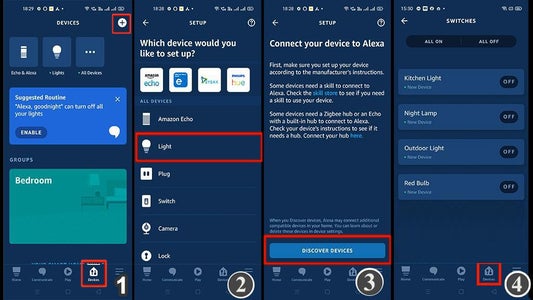

Step 15: Configure the Alexa App to Connect Tasmota Devices
Open Amazon Alexa App and follow the steps:
1. Tap on Devices. Then Tap on the "+" icon.
2. Tap on "Light", then select "Others".
3. Goto Alexa and tap on "DISCOVER DEVICES". It will take a minute to add devices. During this time the ESP8266, Echo Dot should be connected with the same WiFi.
4. Tap on "Devices", and tap on "Lights" to see all the devices.
