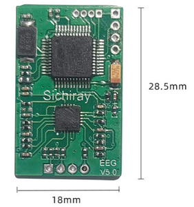

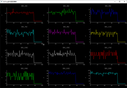

The Taurus EEG sensor module is a module designed for the consumer electronics market to collect single-channel EEG signals. The module integrates analog front-end acquisition and data processing, and can directly output brainwave spectrum, original brainwave signal and two indicators of concentration and relaxation. The module integrates hardware filtering and software filtering, and integrates a 50HZ notch filter, which can filter out environmental interference and improve signal quality. The module is compatible with dry and wet electrodes and is easy to wear. The module adopts serial communication, which can be easily integrated into other devices to assist in the development.
The module adopts serial communication mode, the baud rate is 9600 and 115200, the module outputs α, β and other brain wave band data and attention, relaxation data at 9600 baud rate, and sends the original brain wave signal at 115200 baud rate.

  • The FFT accuracy is up to 1HZ, and the resolution is high.
  • The module directly outputs the brainwave band results.
  • Outputs concentration and relaxation data.
  • Output raw brain wave data.

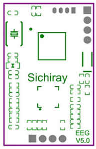

  • Size: 18mm*28.5mm
  • Operating Voltage: 3.3V
  • Working current: 5mA
  • Sampling Rate: 250HZ
  • Frequency Range: 3HZ-125HZ
  • FFT width: 1HZ
  • ADC accuracy: 12 bits
  • Serial port baud rate: 9600HZ,115200HZ
  • Notch filter: 50HZ
