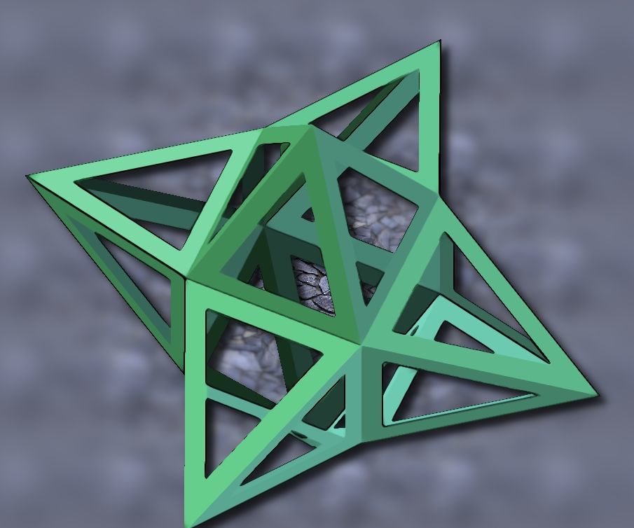

Step 3: Finished STL File
Also included here are the results from Shapeways.
It will take 10 of these (open at bottom as well as top)
to make this - 10 x $ 5.35 (White Plastic) is about $ 54 from Shapeways.
(The Green Arrows in the image simply mean it's been analyzed for printability
and has passed the initial tests. Usually, if it passes the initial tests,
it will be printable.)
