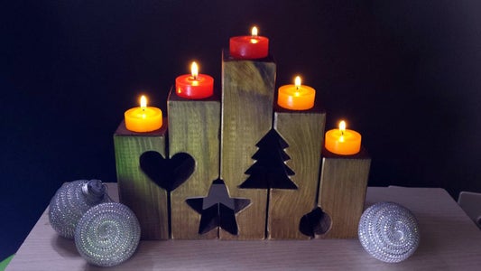

Step 2: The Wood Blocks
For the holders you will need five blocks of wood. You can use any species of wood you like.
Dimensions of the blocks from left to right:
- 12,5 x 5 x 5 cm
- 16 x 5 x 5 cm
- 20 x 5 x 5 cm
- 15 x 5 x 5 cm
- 10.5 x 5 x 5 cm
Cut all the pieces with your saw and proceed to the next step.

Step 6: Marking the Holes
We need to make a hole on the top of each block so we can put our tea light in it. Mark the center of each block with a ruler and a pencil.
Step 7: Last Step
Drill a hole on each block for the tea light and you are done!
Now you can paint your holders the way you prefer or just stain them and apply two coats of spray lacquer on them to protect them.
Have fun making your own!!!
