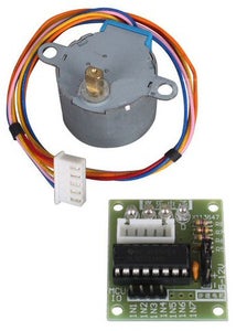

- 28BYJ-48 Step Motor

3.Step Motor Controller - Wire up the step motor controller circuit.
1N1 - Digital 8
1N2 - Digital 9
1N3 - Digital 10
1N4 - Digital 11
+ to 5V Rail
- to GND Rail

5. Step Motor - Plug the step motor into its controller. Simple.
