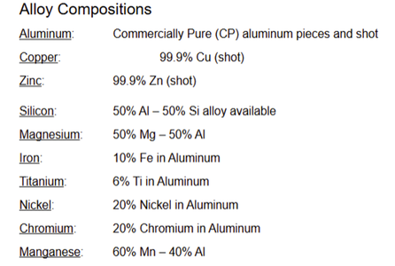

The initial competition requirements were to produce and work an aluminum alloy consisting of at least 90% aluminum. Allowable alloying elements consisted of silicon, magnesium, iron, nickel, copper, zinc, titanium, chromium, and manganese (each with a limit an allowable composition percentage). It would be worked down to 2.5mm thickness in order to cut mini tensile bars for testing.

  1. Aluminum: Aluminum foil and commercially pure aluminum pellets
  2. Manganese: 60% Mn - 40% Al
  3. Copper: 99.9% Cu shot
  4. Silicon: 50% Si - 50% Al
  5. Magnesium: 50% Mg - 50% Al

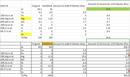

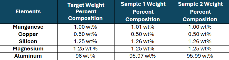

The team chose a 6010-T6 for a few reasons, but the main reason being the great balance between the 3 requirements. This alloy holds sufficient values in the 3 of the areas being tested while not being difficult to work on. Another reason this alloy was desireable was because of the flexibility in adjusting those parameters during processing. The team had to remove some alloying elements due to quantities being so low, they be added to the cast as they could cause potential issues. Therefore, some elements were rounded up in composition instead. The final composition ended up being 96% aluminum, 1.25% of magnesium, 0.5% copper, 1% manganese and 1.25% silicon. This alloy was chosen because of how forgiving it is when casting and processing it. This mostly comes from the low alloy content which makes it a little more forgiving but usually has trades off in other areas.

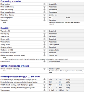

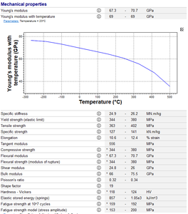

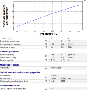

The chosen process schematic was intended to produce an alloy to achieve the hypothetical Granta software properties:
-Yield Strength (0.2% offset): 344 MPa - 380 MPa
-Elongation: 10.6% - 12.4%
-Conductivity: 43.1%IACS - 44.9%IACS

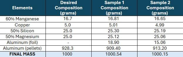

The necessary master alloys were measured out and prepared to be added. The magnesium had to be wrapped in aluminum foil with near to no air trapped inside. If the magnesium was added without this precautionary step, there would be a violent reaction with the air. This amount of aluminum foil was accounted for in the composition calculations.
First off the aluminum was melted in the induction furnace in a graphite crucible, since it is the bulk component of the alloy. Once it melted the minor components were added. The steel molds were preheated to avoid damage to the molds and casts.
The team chose to do two casts due to a large shrinkage hole that went through the entire top half of the cast. The second cast was an improvement and had no visible internal cracking.

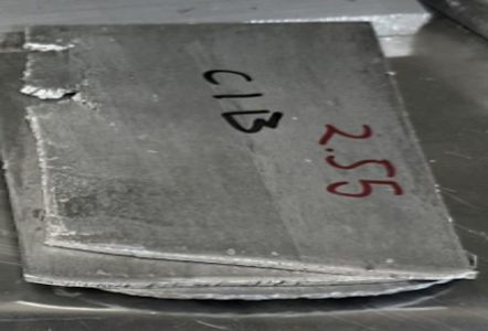

6 of the 9 plates were placed in a furnace at 205°C for different amounts of time. One sheet was for 30 minutes, 2 sheets for 1 hour, 2 sheets for 1.5 hours, and 1 sheet for 2 hours. The other three plates were not aged due to the following reasons:
  1. Two plates (one is pictured - C1B) had extensive cracking from rolling.
  2. One place was saved in the case of having to an alternative aging time if the properties observed were not up to par.
Three plates were sent to be cut into tensile bars: a 30-minute, 1-hour, and 1.5-hour aged plate. They are labeled CDME in red marker. The other three plates and a part of the 30-minute plate were saved for testing purposes, this was done to be efficient in time and ensure the tensile bars were cut in time for the contest date.

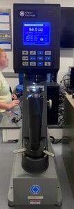

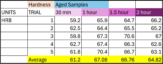

A hardness tester on the Rockwell B scale was used and performed according to the ASTM E18-22. 5 tests were performed for each aging time and averaged out at the end. There was an issue getting accurate results when tests were placed close together. The tests were performed sufficiently far apart enough to achieve accurate results.

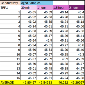

An electrical conductivity test was performed on each aged sample. 15 tests were performed on each sample and averaged out to determine the best sample.

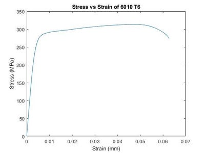

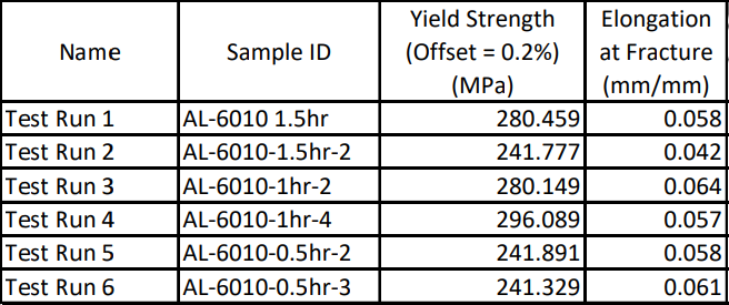

The final test was a tensile strength test which gave us yield strength and ductility. Each sample was measured for length and thickness before test. 2 samples for each aging time, excluding 2 hours, were loaded in and tested. All data was recorded in the software managing the tensile tester. The machine was set to zero before each new tensile bar was loaded in.
The team decided to use the 1 hour aged sample bar for the contest after the tensile tests were complete since it had higher strength while being comparable in conductivity and ductility.

The 6010 aluminum alloy achieved the highest electrical conductivity at 45.99 %IASC which was higher than Granta's prediction. The team scored 3rd in yield strength with a yield strength of 276.8 MPa, and ended 4th in elongation with fracture at 6.2%. In the end, Team Diamondback finished at 3rd overall with a total score of 324,046.
