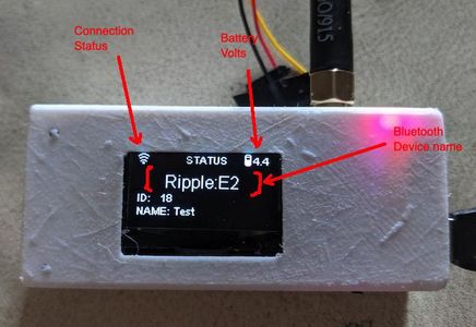

Once the firmware is flashed, you should see the 'Powered by Ripple' startup screen, then a status screen (like above). Initially it will say 'Device is not configured'. The radio module itself now stores your ID/name and encryption keys, and the Android handset only temporarily downloads some of the information while the radio is in use.
The only thing the Android app now stores is the Bluetooth MAC address of the device you have paired.

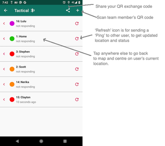

Once the pairing is done, and the radio has had the ID set, you then go about exchanging details with other team members. (see screen above). The 'team' screen is where this is done. You simply scan each other's QR codes to exchange your ID/name and public encryption key.

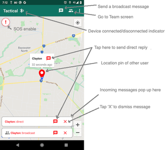

Step 3: The Map Screen
Once your team is setup, the main screen (above) is where all the action is. This will show live, moving map pins of everyone in your team, and has incoming messages popup at the bottom.
You can send direct messages, to a single team member, or you can send broadcasts to the whole team.
Also, there is an S.O.S feature! In the top-left you can simply tap to enter SOS mode, and the rest of your team will receive an alert. The map pin, showing your location, will also flash to highlight the SOS.
To cancel the S.O.S you just tap again, to toggle SOS mode off.
