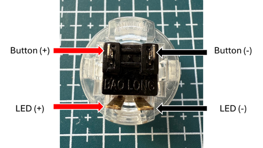

- 3 x 24mm 5V LED arcade buttons – I got mine from AliExpress. Each arcade button has four connectors on its base – a positive and negative for the button mechanism and a positive and negative for the LED.

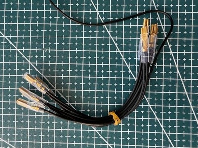

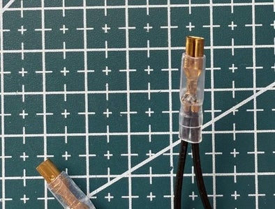

- Daisy chained spade connector wire which are sold alongside the arcade buttons. The picture shows just the black wire side – there is also a red wire side.

Step 3: Cutting Red Wires
Cut 6 red spade connectors with approx. 10 cm of wire off each long wire. You should end up with 6 individual lengths of wire each with a spade connector on the end.
Step 4: Black Wires
Cut one length of black wire so that it has six spade connectors daisy chained together.

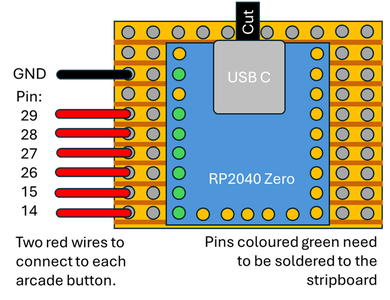

Step 5: Soldering to Stripboard
Attach the RP2040 Zero board to the stripboard and solder the GND pin and pins 14, 15 , 26, 27, 28 and 29 to it.
Solder the black wire to the stripboard next to the GND and a red wire to the stripboard next to pins 14-29 as shown. Note that in my photograph you can see that I’ve got a bit too much bare wire showing – that’s not ideal so try and do better than I did!

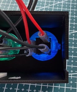

Push the arcade buttons into the holes in the 3D printed case. The base of each arcade button shows a positive and negative symbol.
Attach one red wire spade connector to each positive pin – again there are two on each arcade button. You need to attach the positive wires to each button as shown in the table in the picture (or you can attach them in any order and then adjust the code later).
Attach a spade connector from the black wire to each negative pin – there are two on each arcade button.
