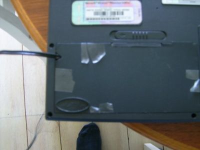

Step 4: Replace Remastered Battery
I had to cut a little hole for the wires to pass out of the battery casing, remember to thing about this and to do it so that the wires come out in a handy place, don't do this if you don't want to spoil your battery casings good looks.
Step 5: Testing the New Power
It has to be said that I had to use the A/C power connector to boot the laptop but after that it worked fine without the A/C power, I don't know whether this was because the laptop is old or it couldn't recognize the batteries to boot the laptop, but it did recognize the batteries with the A/C power plugged in and the laptop off.
