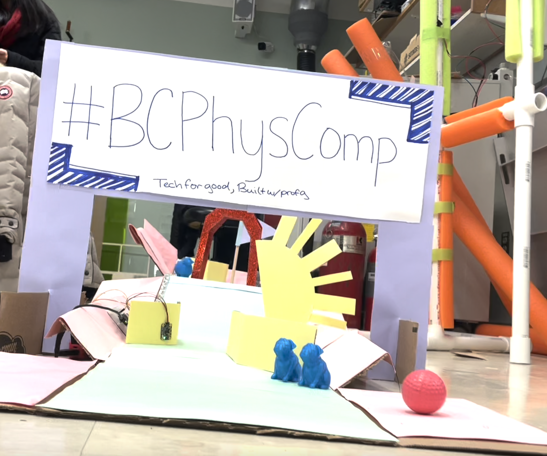

Funny story.. both of us had never really build anything of such a scale before, yet we were very excited for this opportunity. We started out by doodling out our concept and proceeded to home depot to gather some pvc pipes, pool noodles, and etc.
Step 3: Cutting PVC Pipes & Circular Diorama
Once we had our materials, we headed to BC’s Maker’s Space where we learned how to cut the pvc pipes to the right sizes (we ended up cutting 4 of the pipes in half to create the base of our stand).
Next, we needed to create a light base for the diorama of 3D printed figurines. We ended up laser cutting an acrylic circle with a small hole in the middle that fits around the pvc pipes. As you can see from the picture, the blue acrylic circle was just the right size to stay upright when we attached them to the pipes.
Since we didn’t want our structure to fall forward, we decided to add more back support to the standing post.

Get your glue guns ready! Creating this hanging mobile was extremely fun. We ended up laser cutting a thin rim to support our decorations. Our student likes pastel colors, specifically purple, so we created some origami animals as well as attached a sparkly boa to make it more festive. You could definitely create different decorations!
Our main goal was to make this stand as mesmerizing as possible, even before we attach the CPB and other gadgets (which we intend to enhance the final product). You should definitely make sure that the stand is stable before adding your attachments.

Finally, we can attach all the pieces together. We wanted to make sure that our stand remains portable and cushioned against unforeseen mishaps. Thus, we covered the pipes with some pool noodles. Additionally, the Green and orange pipes are detachable as we glued down everything else but that area to ensure that it is collapsible. You can definitely attach all the pieces permanently though!
