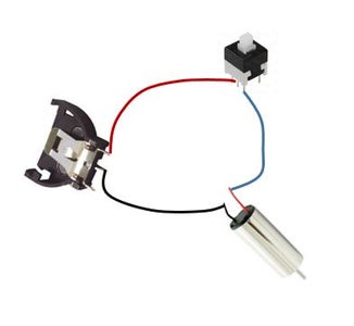

To create the propeller, we need a small general purpose PCB, a button cell holder, a button cell, an on/off push button switch and a propeller micro motor. (I used one like used in micro quadcopters. You can use other micro motors like a modified cellphone vibration motor. However you will need to build a small propeller blade yourself in that case.)
Start by making a hole in the PCB, roughly the size of skewer wooden stick. The stick should fit into the hole tightly. (The propeller board will be fixed to the stick using this.) Then solder the switch and cell holder on the PCB. Glue the motor using super glue or similar other glue. Then solder according to the given circuit.
Since the propeller board can be rotated on the stick, you can have different rotation speeds of the bot by simply adjusting the fan orientation.
