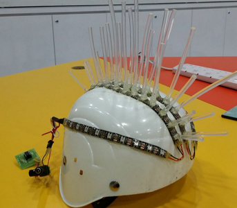

Step 1: Wiring Up the Hardware
feel free to use any breakout board of choice for ATTiny85. In this example, a customized PCB is used.
The wiring is identical to the one explained in adafruit neopixel uberguide
Data pin from the addressable WS2812 RGB LED strip to pin of your choice. In this case, digital pin4 of ATTiny85. a 10k resistor is used between the data pin of the ATTiny85 and WS2812 RGB LED strip data pin. NOTE: must ensure common ground by connecting ground wire of RGB LED strip to ground pin of MCU.
supply is 5v 1A from a mobile power bank that is meant to power up a smart phone
The LED strip is then stick to the toy helmet with some adhesive, and the assorted length of side glow fibre optic cables is applied with hot glue to the individual LEDs' on the LED strip.
