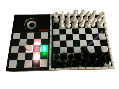

Hello, we're Los Atômicos Team, from Brazil 👋
We're a FLL® (FIRST® Lego® League) team, for the competition, this year we decided to improve the ways of teaching chess, with the guiding question: "How can we engage more people to play chess through art technology".

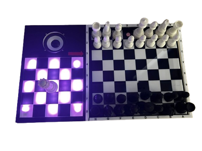

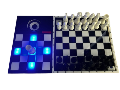

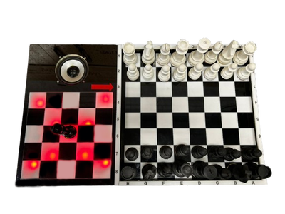

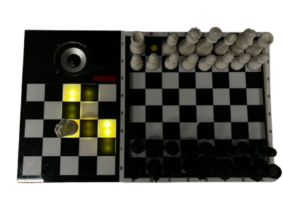

Master Chess is able to teach the movements, positions and names of all of the chess pieces.
Our target public it's children aged 4 and over, the board has a playful way to teach, we could comprove it's efficiency with children aged 4 to 10 years old;
It is important to emphasize that although the target audience is children, people of any age can learn with our project, the target audience defination was based in the way the our research and development was made.

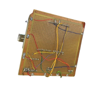

Step 2: Eletric System ( USE PPE!)
To create the electrical system you will need:
- Arduino Uno
- Island type standard plate 10x10
- Soldering Iron
- Tin
- Mp3 Module
- MicroSD memory card
- 5V addressable LED strip
- Speaker
- TCS3472 color sensor
- On/off button
- Support 4 AA batteries
- 2 4-Way Sleeve Cables + Connector
- 1 Resistor 330 ohms 1/4W
- Yarn roll
- 4 AA batteries
File with links:
https://drive.google.com/drive/folders/1sDGGiL5tyqx_OQK5jozTsE1mNFSMWzTK?usp=drive_link

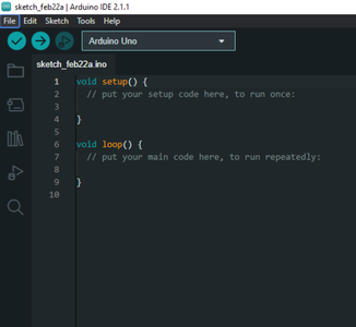

Step 4: Programming
Link install Arduino IDE:
https://www.arduino.cc/en/software
Link to open programming
https://docs.google.com/document/d/1OCUd6vHQuBGlAiR14dqfMVm8EvrwtpbliphkKsj3QwE/edit?usp=drive_link
