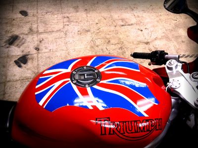

Ever since I got my little British bike I've been wanting to put a Union Jack decal on the tank. My first attempt failed miserably because I didn't account for the curvature of the tank at all. My second attempt also failed miserably because I tried to do my measuring with the decal (not affixed) on the tank. This is the third attempt and I took a different tack. I first created a template of the parts of the tank that would allow the decal to lay flat. Here is how it went...

I've already written an Instructable on making decals so I'll skip that part. This was a two-layer decal so it was a little more fun to make and align.
Since my Union Jack is 4 parts on a red background I was able to make it larger than if it were one solid piece. In making my template I tried to account for the spaces between the decal sections. This also meant that the sections didn't need to be exactly the same size since it wasn't symmetrical.
With this in mind I laid the template over the decal to observe how it was best suited to the tank and the cut. Once I decided on the decal layout I cut it out.
Applying it was the hard part. First I cleaned the tank. Then I peeled off one of the quarters and sprayed a liberal coat of Rapid Tack on the decal adhesive side. This made it much easier to apply to the tank and maneuver into the desired position. I did make a small mistake in trying to cover a chip in the paint. It upset the alignment of my decal. It didn't cause the decal to wrinkle or bunch though so I am happy with the result. I'll fix this in the next version.
