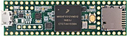

- Teensy USB Development Board

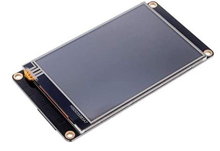

- Nextion Display

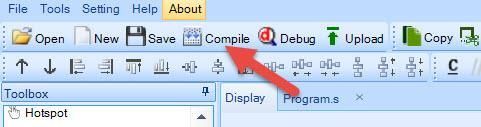

Step 3: Nextion Editor
- Download Nextion Editor and Install it
- Start Nextion Editor
- In the Nextion Editor click on the "New" button
- In the Window set the name for the Project like "LED"
- In the "Setting" window select the Model of your Nextion Display & click "Ok"
- Select Display Direction 90 & click "Ok"
- In the Editor on the left in the "Toolbox" find "Dual-state" button & drag it to the right
- Center & Resize the Button
- In the Menu click on the "Tools" > "Font Generator"
- In the "Font Creator" window set size to 64 and set the Font name & click "Generate Font"

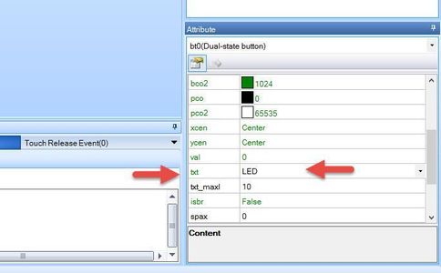

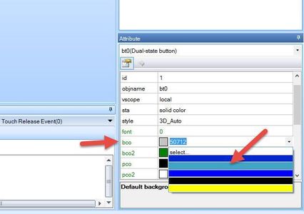

- Select the Button
- In the "Attribute" window set "BCO" to Blue color
- In the "Attribute" window set "txt" to LED

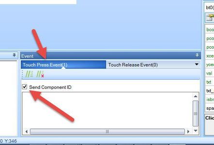

- In the "Event" window > Touch Press Event" Check the "Send component ID"
- In the "Event" window > Touch Release Event" Check the "Send component ID"
- In the Toolbar click on the "Compile" button

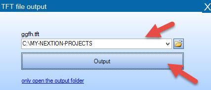

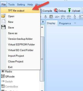

- In the Menu Select "File" > "TFT File Output"
- Set the Output folder & click on the "Output" button

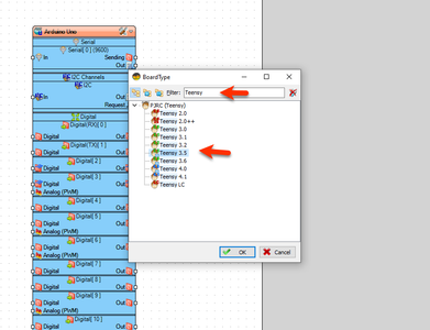

Step 4: Start Visuino, and Select the Arduino Teensy Board Type
The Visuino: https://www.visuino.eu needs to be installed. Start Visuino as shown in the first picture Click on the "Tools" button on the Arduino component (Picture 1) in Visuino When the dialog appears, select "Teensy" board as shown on Picture 2. In this project we we will use Teensy 3.5 board.

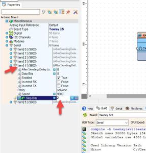

Step 5: In Visuino Set the Teensy Board
Select the board and in the properties window expand "Serial" > "Item[ 4 ] (9600)" and set the "Stop Bits" to 2

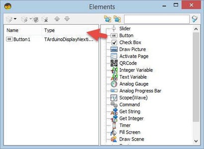

- Double click on the "DisplayNextion1" And in the Elements window drag "Button" to the left side.
- And close the Elements window

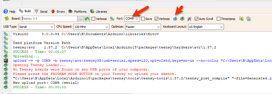

In Visuino, at the bottom click on the "Build" Tab, make sure the correct port is selected, then click on the "Compile/Build and Upload" button.
