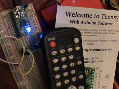

Step 2: Attach the SD Adapter
So here we go, you attach your sd adapter to you teensy 2.0. This is pretty easy, just look at the top of your teensy then place the adapter on top with the sd card pointing toward the usb connector and solder it on. If you have the Teensy++ you will have to use different pins listed on pjrc.com.
*I did mine a bit differently, I solderd pins on the bottom, then a dip socket on top of the teensy, and then put pins on the sd adapter, so it all plugs together. I am using this teensy as a prototyping device. I do not have the money to buy a teensy for all of my projects.
