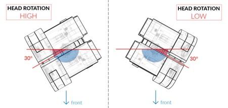

1.      The sketch is used to calibrate the maximum and minimum PWM pulse lengths required to move each servo motor across its desired range of motion. The standard LOW and HIGH positions of each of the servos is shown in the images below.
2.      When starting the sketch and opening the serial monitor, a message should appear after 2-3 seconds, saying that it is ready to calibrate the LOW position of the first servo motor (the head rotation).
3.      Send the character ‘a’ and ‘d’ to move the motor backwards and forwards by -10 and +10. For finer control, use the characters ‘z’ and ‘c’ to move the motor by -1 and +1.
4.      Once the motor is position in the correct position (as shown in the images below), send the character ‘n’ to proceed to the calibration step. It will move on to the HIGH position of the same servo, after which the process will repeat for each of the 7 servos in the robot.

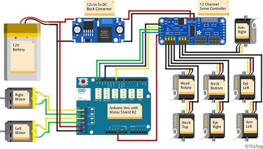

Step 4: Wiring and Electronics
Diagram of electronic components

1.      Ensure that the wiring of the electronics matches the circuit diagram.

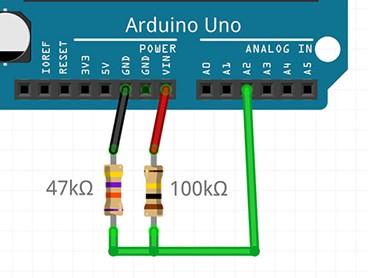

1.      To use the battery level detection feature on the Arduino, connect the following resistors and wiring as shown in the image. The resistors (potential divider) reduce the 12V voltage down to a value below 5V, which is safe for the Arduino to measure using its analogue pins. The recommended resistor values are R1 = 100kΩ and R2 = 47kΩ.
2.      Uncomment line54 in the main Arduino sketch WALL-E.ino.
3.      If you are using different resistor values, change the value of the potential divider gain factor on line 54 of the sketch, according to the formula: POT_DIV = R2 / (R1 + R2).

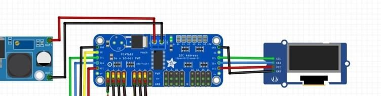

1.      To use the Led display feature on the Arduino, connect an i2c Led display on the i2c bus on the servo motor module (see diagram).
