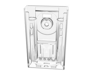

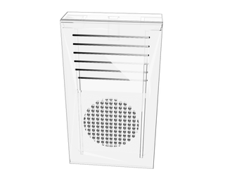

Step 1: Step 1: 3D Print the Case and the Lid
You find the STL files needed for 3D printing attached to this step - or - you can download them here:
github.com/sy2002/TeleBall/tree/master/cad
Here are some further instructions teleball.org/doc/case.html
