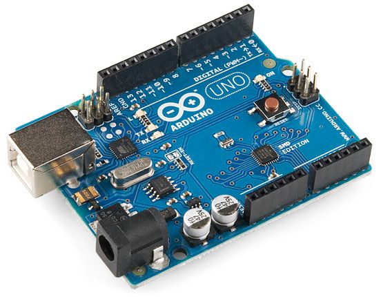

With an arduino, some resistors, and an RCA plug you can make personalised messages appear on your tv or any lcd screen that has an RCA video input.

So you need;
an Arduino(kinda obvious??)
a 1k resistor
a 470 resistor
an RCA cable
a few jumper wires
breadboard.
I was lazy and didn't have any 1k or 470 resistors so i used 3 330 Ohm resistors instead of the 1K resistor and 1 330 Ohm resistor instead of the 470 Ohm. Mine works just fine.

Step 2: The Wiring!!!!
Use the image, its the best way!!!!!!!;)
For the RCA plug, the outside is the ground and the inside is the Video.
