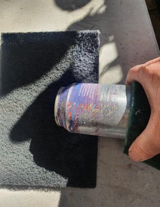

Step 1: Removing Paint From the Cans
A couple of beverage cans will be used in making this simple telegraph. The paint needs to be removed from the cans so a good electrical connection can be made. There are two simple ways to do this:
  1. Rub the paint off a full beverage can using a course scourer.
  2. Once the metal from the can has been flattened, remove the paint using 120 grit sandpaper.

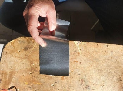

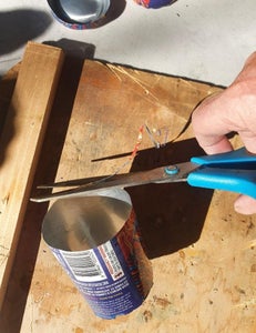

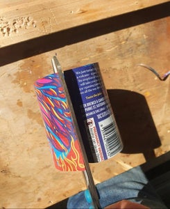

Step 2: Flattening the Cans
Remove the top and bottom from two aluminum beverage cans using a sharp knife. Trim the rims with a pair of scissors. Cut down the length of the of a can and then make flat by moving the aluminum sheet against an edge.

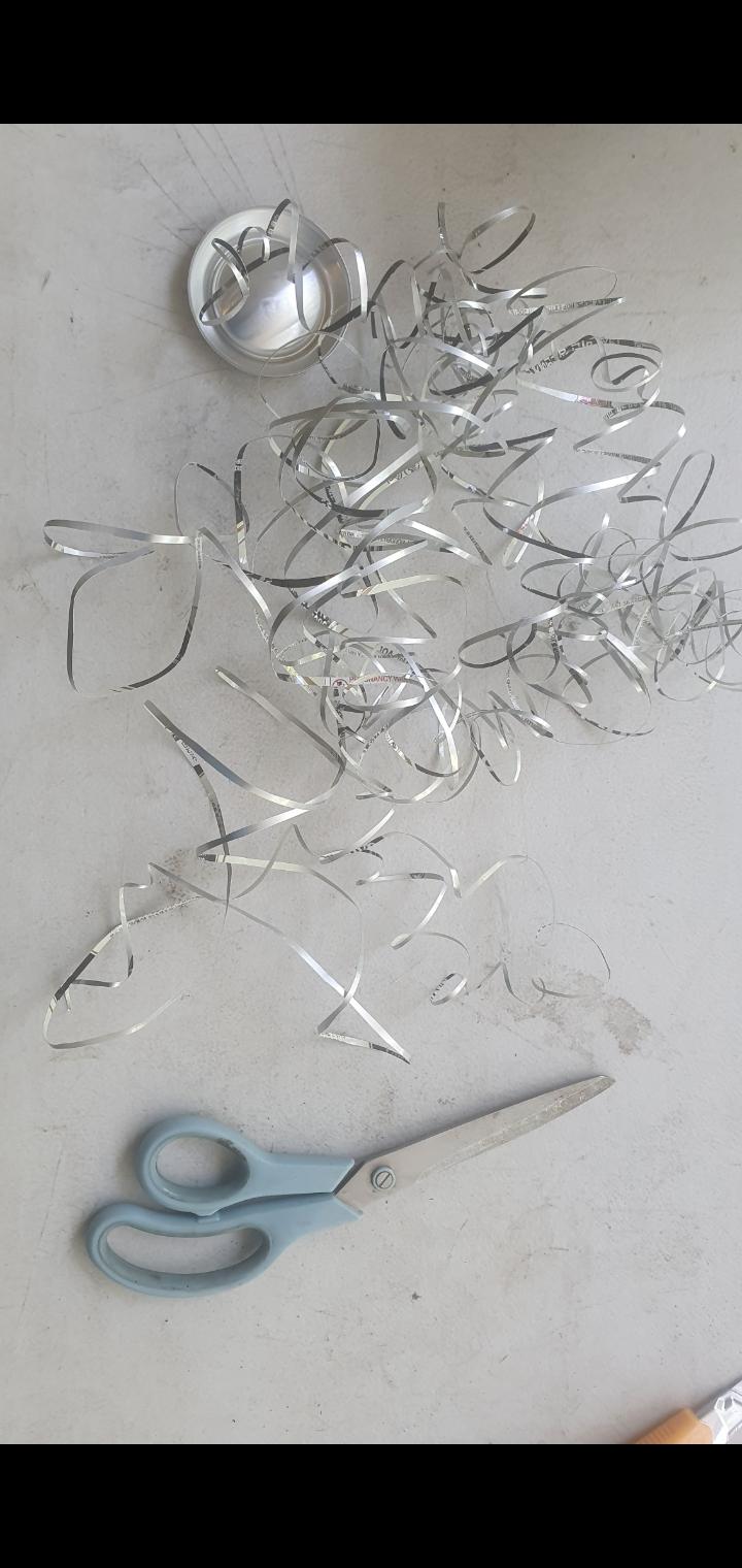

Step 7: For Longer Distances
To Send morse code longer distances, just have longer wires between the two morse code keys. Here's how you can make some wire from empty Beverage cans.
