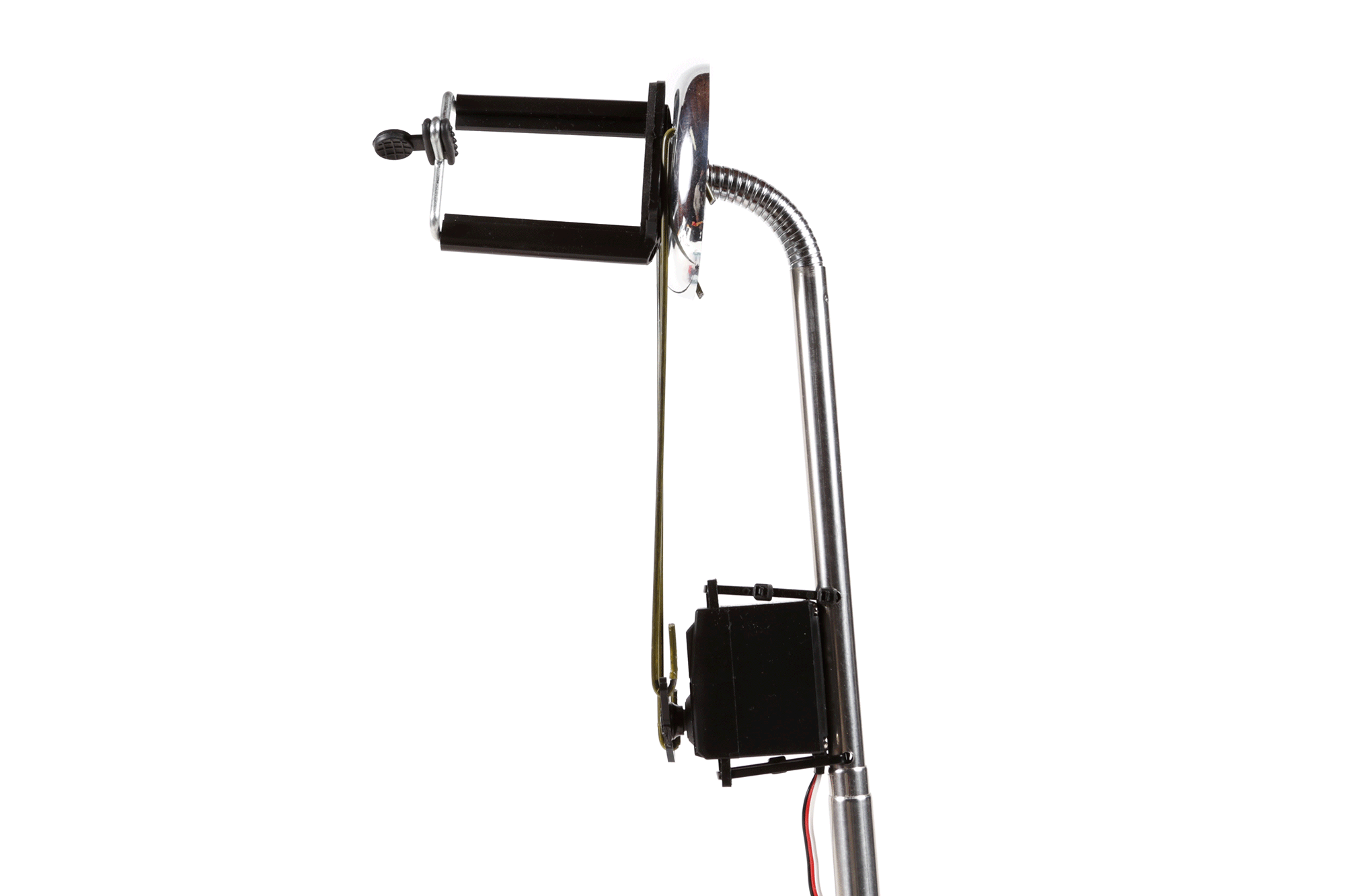

The second part of the telepresence robot platform consists of a motorized selfie stick that is able to rotate a phone up and down. This will ultimately give the viewer on the other end some ability to control where the camera on the phone is pointed.
To make this work, a standard servo is attached to the selfie stick. Rods extending from the servo horn are attached to the bracket which is holding the phone. When the servo horn rotates, the phone holder rotates to mirror this motion. This allows the phone to be tilted up and down. It is a very simple and effective mechanism.

Step 9: Extend
Fully extend the telescoping arm of the selfie stick if you have not done so already.
Step 10: Mark and Drill
At the base of the outermost segment of the selfie stick, position the servo motor.
Make a mark on the selfie stick to indicate where each set of mounting holes are on the servo. These will be used for drilling holes clear through the selfie stick to mount the servo.
Since the selfie stick tube is round, you will likely want a drilling guide to make sure your holes are on center. In order to accomplish this, place a mini screwdriver tip on the center of the markings and gently tap down with a hammer. This should create a slight indent in the tube.
Finally, use each indent as a drilling guide to make 1/8" holes clear through the tube.
Step 11: Attach
Using the holes that were just drilled and the mounting holes on the servo, zip tie the motor to the extended tube of the selfie stick.
Extend the zip ties if necessary, and trim away any excess plastic tails.
Step 12: Reattch
Twist the phone holder back onto the end of the selfie stick (if removed).
Step 13: Metal Rods
Take a metal coat hanger and using diagonal cutting pliers, create two 8" straight metal rods.
Step 14: Bend the Rods
Take a pair of pliers and bend one end of each of the rods 90 degrees to form an "L" shape.
Insert a bent end into each of the widened holes in the servo horn. Place the other end of the rod along the corresponding edge of the ceiling flange plate.
Mark the rod where it aligns with the 3/32" hole drilled in the edge of the ceiling flange plate.
Remove the rods from the servo, and again using pliers, make another 90 degree bend where the second markings are.
Step 15: Attach the Rods
Insert the bent rod ends through the servo mounting holes and the ceiling flange plate holes respectively.
Again, use the pliers to fold the ends of the rods back towards themselves to lock them in place.
Try manually rotating the servo horn back and forth. It should turn the phone holder unobstructed. If the ends of the rods happen to collide with anything that prevents it from rotating, bend them further inwards or trim them away with diagonal cutting pliers.
