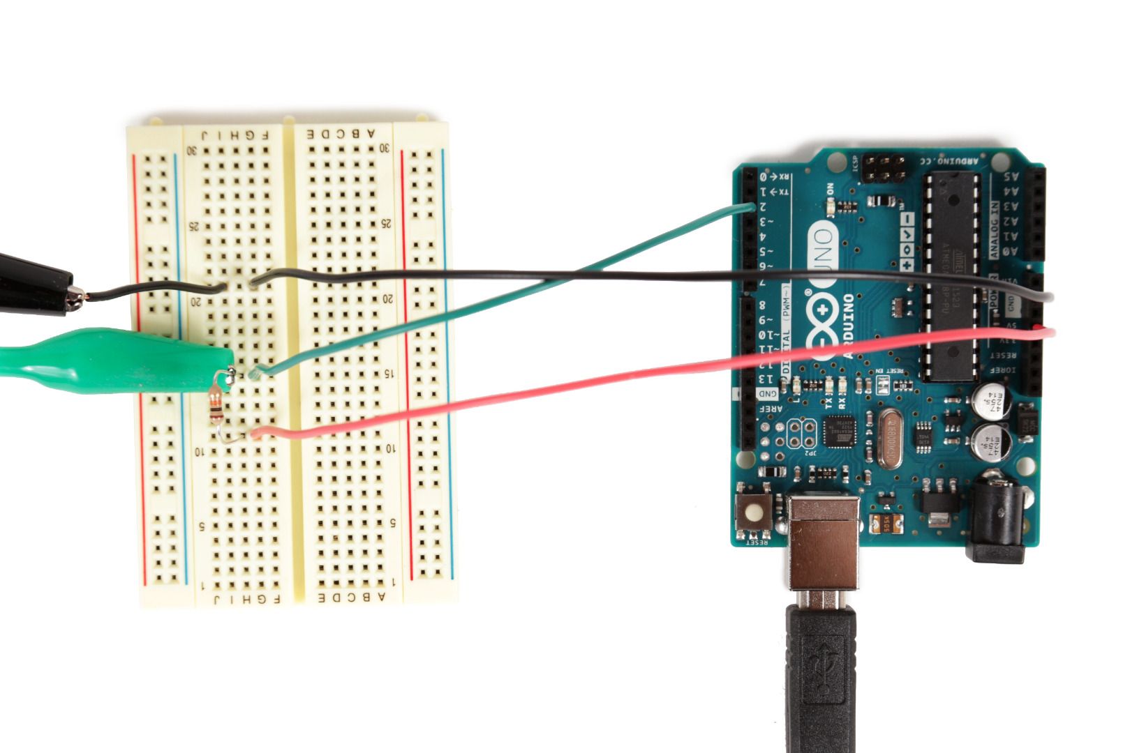

Step 2: The Switch Circuit
As mentioned, a switch makes or breaks an electrical connection. By building a particular circuit, we are able to use the Arduino digital input pins to tell whether or not a switch is making or breaking a connection.
To build this circuit all we need is a switch and a 10K resistor.
We first connect the 10K resistor between the 5V power source and the input pin. By doing this, we are essentially connecting the digital input pin to power, and the Arduino reads this pin as being "HIGH" or 5V.
The magic comes in when we connect the switch between the digital input pin and ground. When the switch is not being pressed, it is like it is basically not there. However, when the switch is pressed, the pin no longer is connected to 5V, but is connected to ground instead.
You might be confused as to why, but this has to with the path of least resistance. The switch has no resistance, and offers electricity the easiest path to flow. So, electricity flows between the digital pin and ground, and bypasses the path that leads from the resistor to power. This configuration lets the switch toggle between power and ground without shorting any wires.

Step 12: Plug in the Switches
Plug the red switch wire in the 5V socket, the black wire into one of the ground sockets, and the green wire into digital input pin 2.
