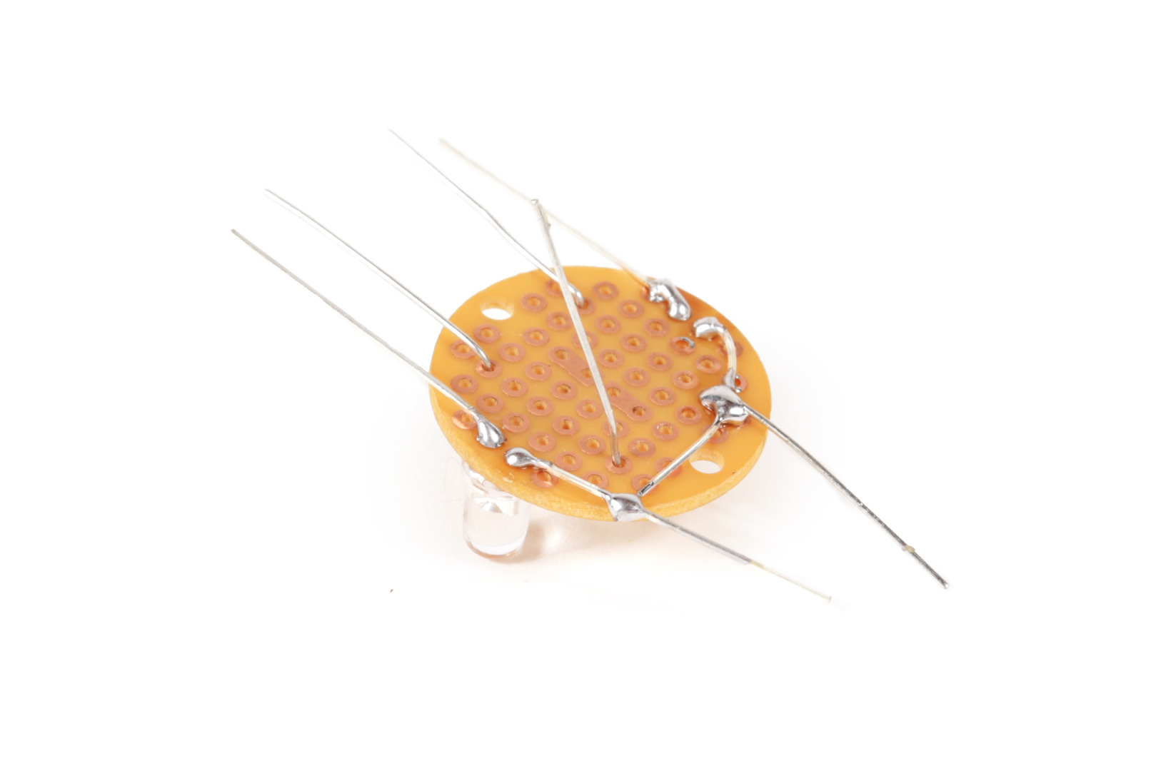

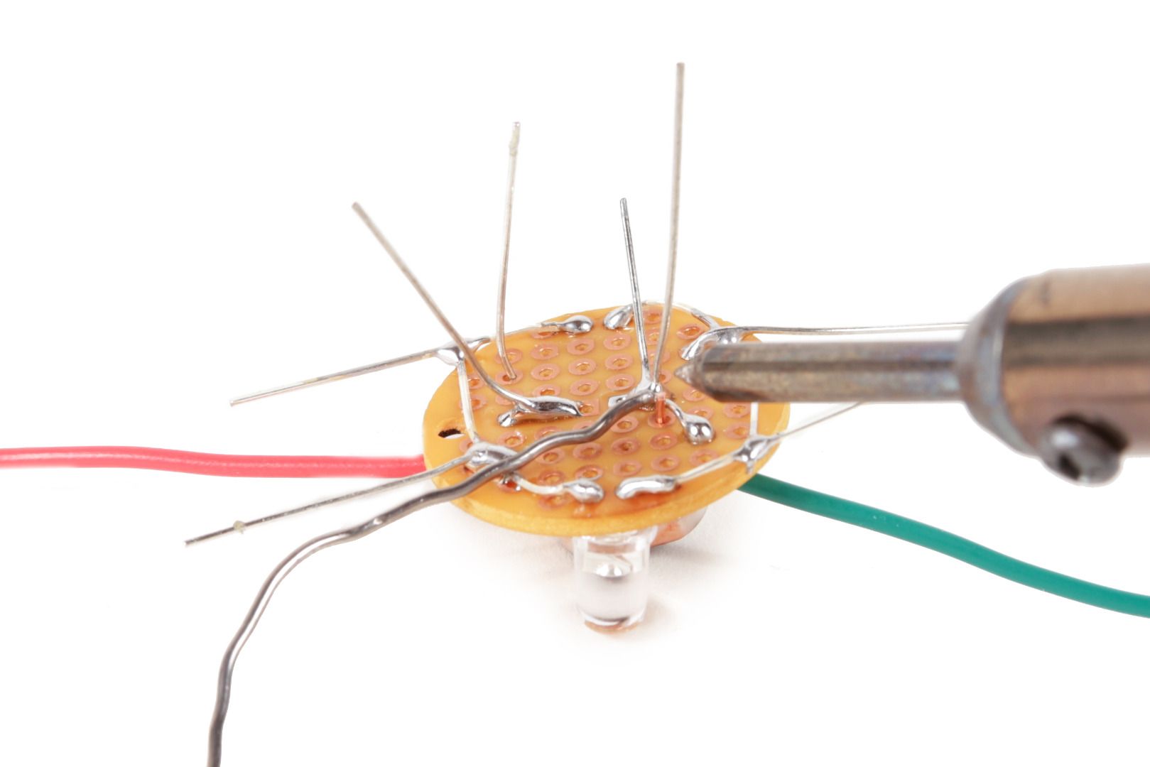

Once it is working on a breadboard, the next step is to build the circuit on a PCB (typically printed circuit board, but or in our case, prototype circuit board). To do this, we are going to solder the components to the board according to the connections in the wiring diagram.
Some PCBs have long metal bus traces on them similar to breadboards. However, the one we are using does not. It just has lots of individual unconnected solder pads. As such, we're going to free form the connection on the underside of the PCB. What this means is that instead of connecting the components through metal bus lines, we are going to literally make each connection by soldering the component leads together. If a connection is to be made, the leads must touch and be soldered.

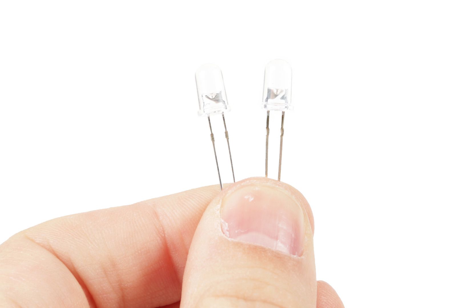

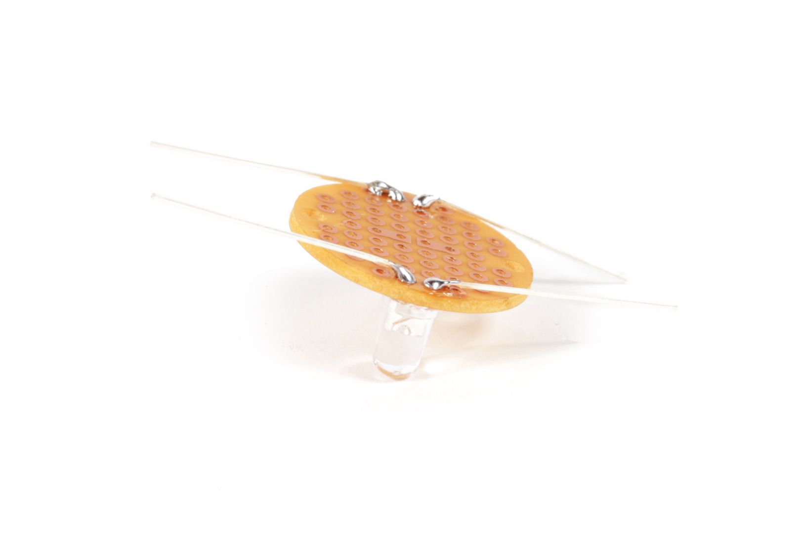

To start, insert the LEDs, bend the leads outward to hold them in place and then solder them to the circuit pads where they have been inserts.
Next, insert the resistors. Again, bend the leads and solder them to the solder pads.

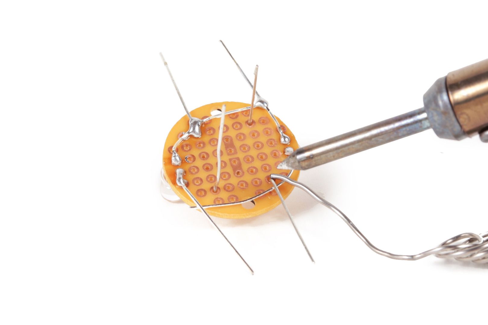

From here, we want to bend the ground leads of the LEDs such that they intersect with one of the leads of the 10K resistor. Make sure they are not touching any other component and solder them together.
Next, repeat this with the power leads of the LEDs and one of the leads of the 100 ohm resistor. Solder these together as well.

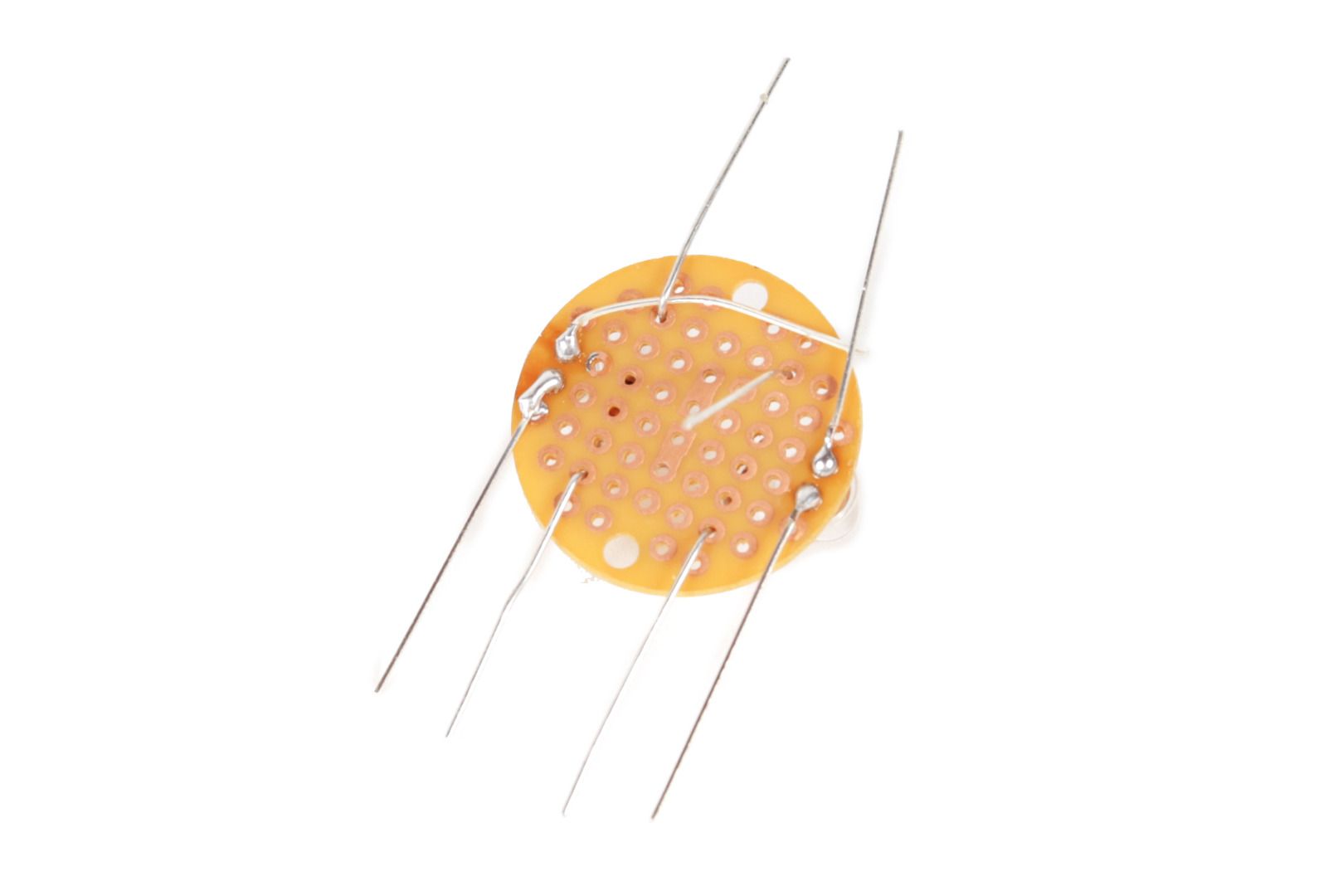

Finally, insert the photocell such that the surface of the sensor is aligned with the top of the LEDs. Solder both of the photocell leads to their corresponding solder pads. Then, attach one of the photocell leads to remaining lead of the 10K resistor.

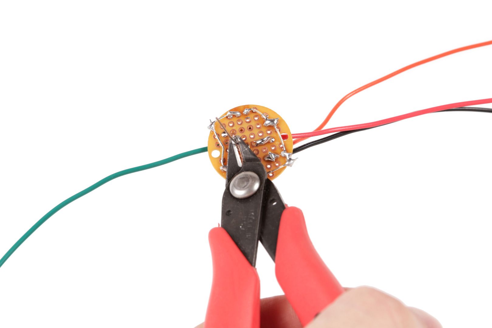

Once all of the connections between components are made, the last step is to connect the wires.

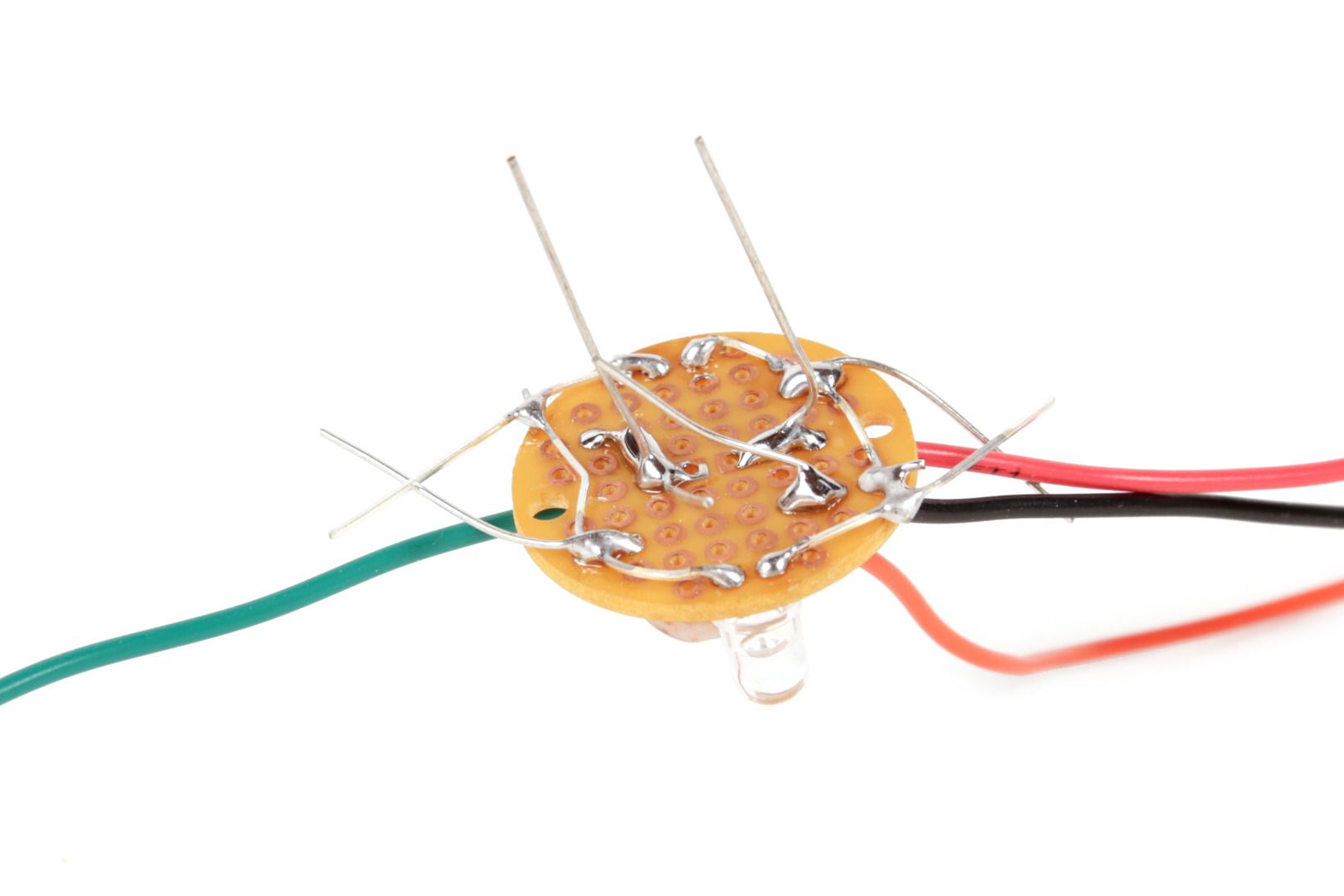

To start, connect a 12" solid core red wire to the last remaining lead from the photocell.
Then, solder a 12" solid core green wire to the junction between the photocell and the 10K resistor.
Connect a 12" solid core black wire to the LED ground leads.
Finally, connect a 12" solid core wire of color of choice (I used orange) to the 100 ohm resistor connected to the LED power leads.
Trim away all the excess leads until it is nice and clean looking. Examine carefully to make sure none of the connections have accidentally crossed. Once sure nothing is touching that shouldn't be, you're done.
