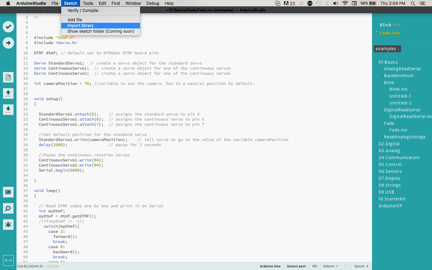

Step 10: Install the Library
An Arduino library is a collection of Arduino pin assignments and functions designed to perform a specific task. Instead of adding each of the functions individually, we can just #include the library at the top of our code, and call the functions within the library at will.
We have already encountered a library before. We used the Servo Library to setup and control servo motors. This library came pre-installed in the Arduino software, and we did not need to install anything to make it work. The DTMF library, however, does not come pre-installed. So, we need to load the library into the software so that our code can use it.
It is necessary to do this because the DTMF library is required to use the DTMF shield. In fact, many Arduino shields have special libraries required to use them. While installing them is mildly annoying, they will ultimately make your life much easier.

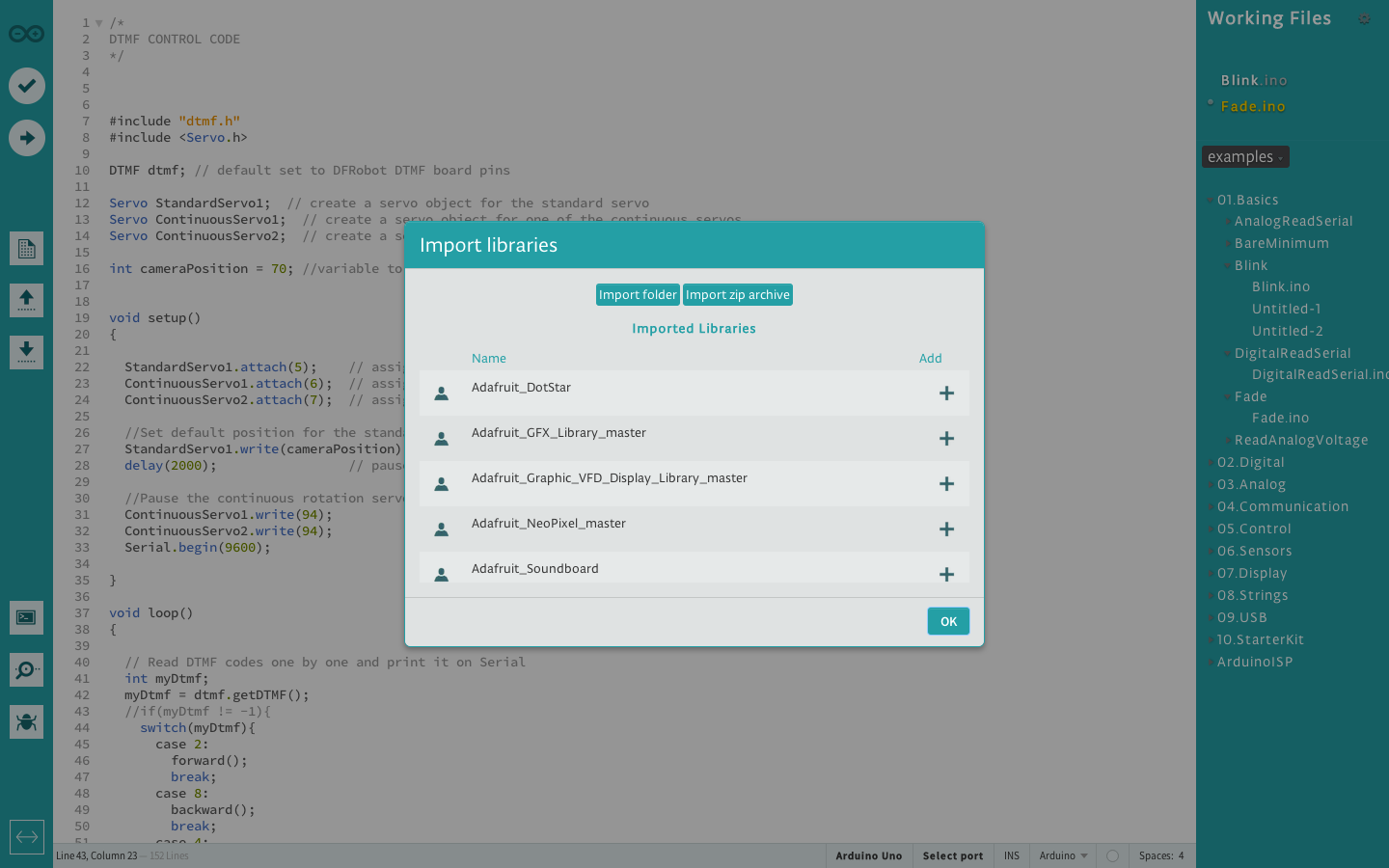

Download the DTMF_Read_Only_Library.zip file.
Install the library by selecting the "Install Library" dropdown from the top menu bar.
Next, select "Import Zip Archive" and select the DTMF_Read_Only_Library.zip file.
And that's it. You're done.
Note that this is a special version of the DTMF library that I have modified to remove the DTMF tone generation capability from the shield. With this library, the shield can only read DTMF tones, as opposed to read and generate DTMF tones. I have done this because we have no reason to generate tones when using our robot, and in order for the shield to have the ability to create tones, it required that pins 2 and 3 of the Arduino be assigned as special outputs. Clearly this is a problem because we are already using pins 2 and 3 for our sensors. Thus, I disabled this functionality in the library. Rather than have these two pins communicate with the shield, I have freed them up to connect our sensors.
Step 11: Reprogram the Arduino
Program the Arduino with the following code:

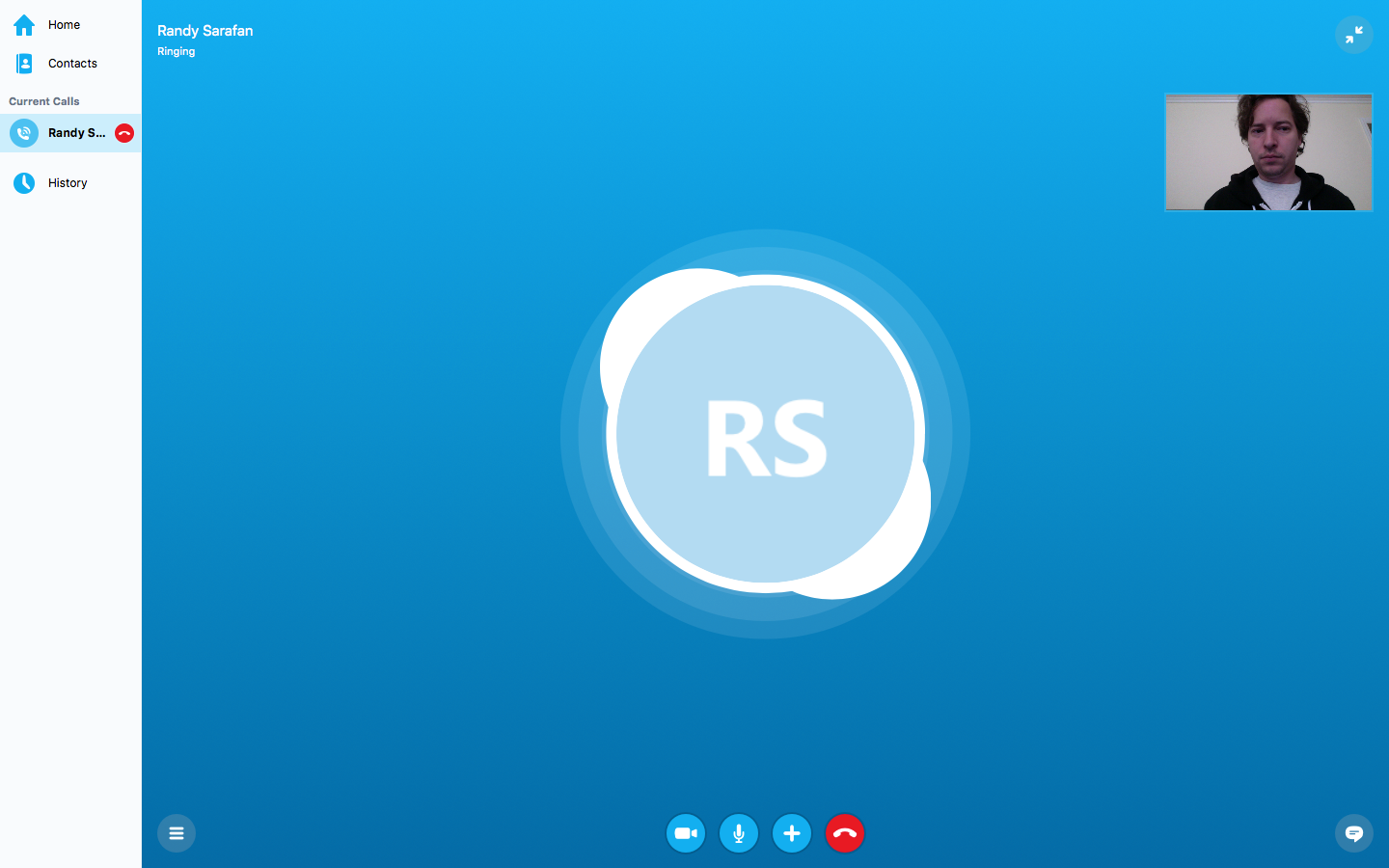

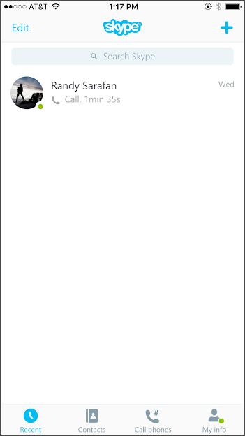

Step 14: Connect to Skype
This robot is controlled through Skype. You will need at least one Skype account and a friend who also has Skype. To test this on your own, you will need to create two Skype accounts.
This also requires a smartphone running the Skype app and a computer running the Skype software.
Open the Skype app on your phone.
On a computer, log in to the Skype software and place a video call to the account open on your phone.
Accept the call on the phone.

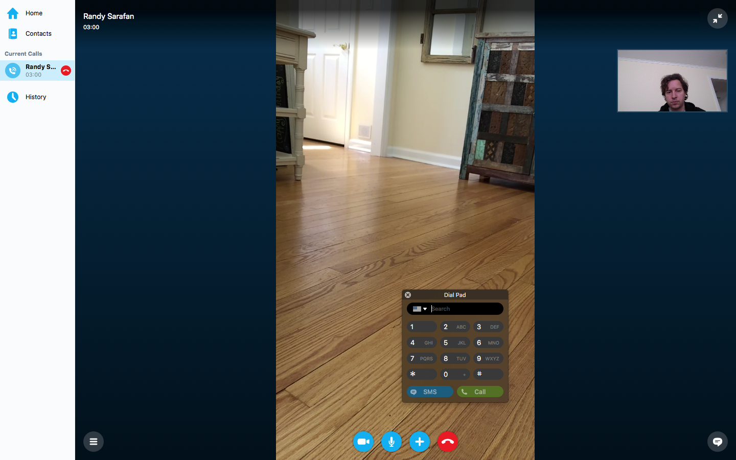

Once the two apps are connected, open the dial pad on the computer. This dial pad can be found under the Window dropdown in the top menu bar or launched by pressing Command 2. The dial pad is used for controlling the robot.
Step 15: Test It Out
When the buttons on the key pad are pressed, it plays a DTMF tone through the smartphone. This tone is sensed by the microphone module and interpreted by the DTMF shield on the robot. The robot then moves depending on which tone is sensed.
The following commands are used to control the robot via Skype:
2: Forward
4: Left
6: Right
8: Backwards
7: Tilt Camera Up
9: Tilt Camera Down
