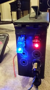

I sized up the batteries in the ammo can (US .30cal belt) and marked out my holes. I used google sketchup and did a base hole chart. My original plan had been to have dual 12V meters left and right, but as with so many things built from scratch plans change mid-stream.
Step 4: Should Have Gone Plastic or Admire My Monkey Feet, Admire!
Ok, after drilling base holes in side. Its time to size them. The meters and 12V and USB sockets advertise 1 US inch. Make a note now, A US inch does not equal a chinese inch!
The biggest drill i had was a 1/2 carbide. ( I really didnt think about this till I drilled about the 3rd hole).
The meters / USB / 12v were 1" , how was i going to turn a half inch hole into a 1" hole, With a dremel tool.
The first 1" hole took 1.5hrs. Build Note- real ammo cans have f'n hard steel. Go plastic on next one.
The other 1" holes my neighbor had a fix for, he thought. He has a commercial size drill press and just happened to have a 1" carbide end mill bit. Not the safest, but it worked. Should have gone plastic. Even with the mill bit, and one person steadying the press, the other trying to work 1" bit into a 1/2" hole. It still took about 30 mins per hole to open them up. Go plastic. Please wear safety glasses during this. This stuff is really flying fast when it hits. And its all hot and sharp.

Step 7: Testing for Magic Blue Smoke Failures. Its Alive!
Time to start showing that you actually know what you're doing.
Wired up batteries. 12v cig lighter socket in place. Got the meter out and lets see whats gonna happen.
I grinned, and said, see it didnt explode and it works the first time. Its alive!
Step 8: Show Time
Pics for details at this point.
Works beautiful.
