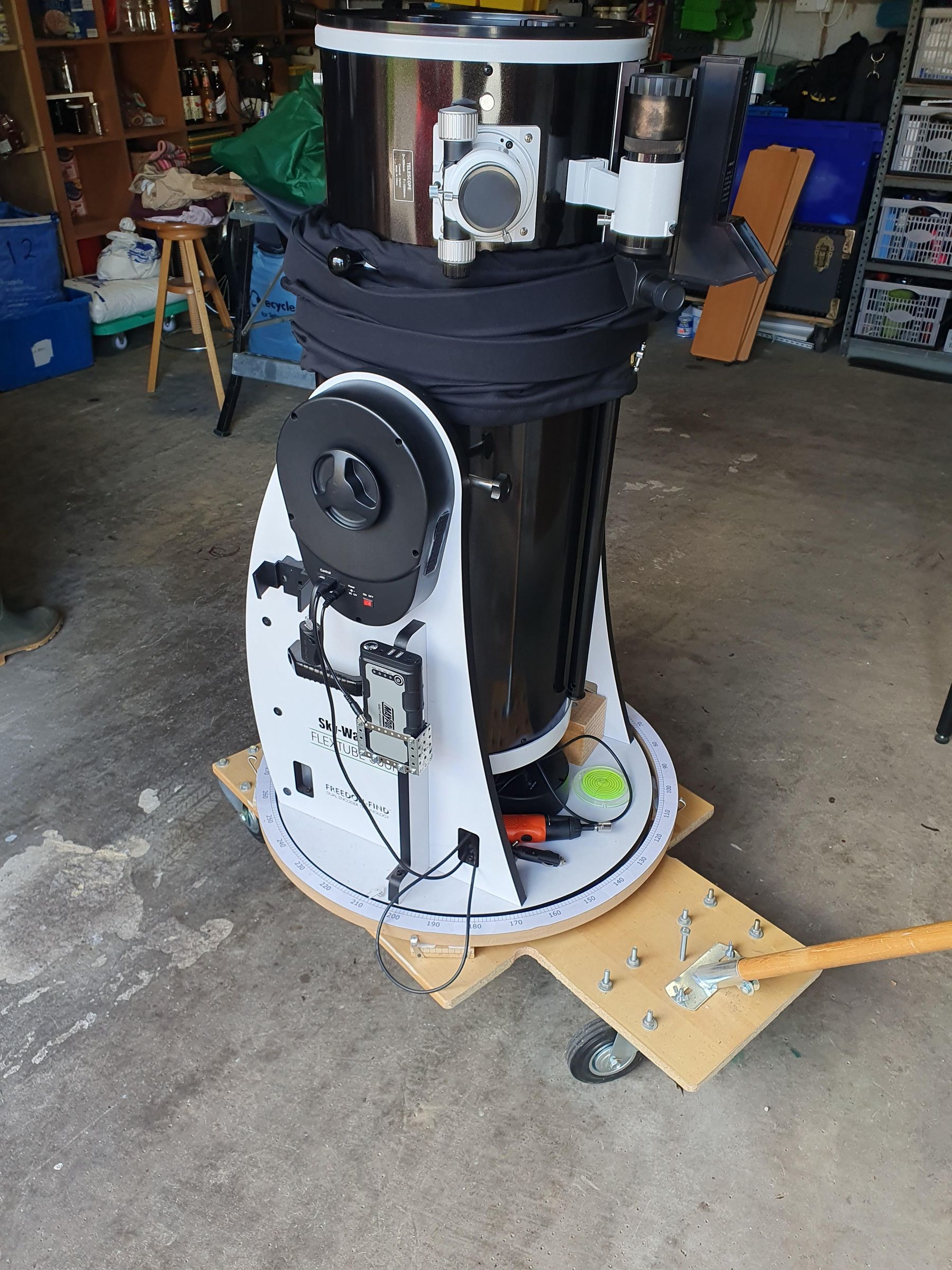

Step 8: The Finished 305p Telescope
The same process was followed for the 305p telescope. As it is a significantly larger and heavier unit, I have built a wheeled trolley and I was able to make Setting Circle supports that could be retained between the base of the telescope and the trolley thus avoiding a need to attach something permanently to the telescope.
