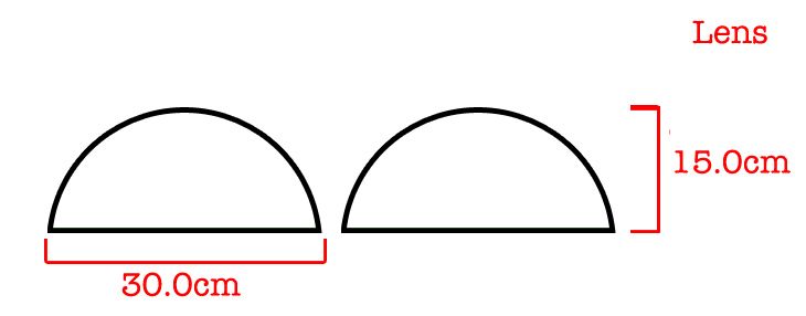

Step 6: Lens
Now, it is time to make the "lens".
You will need to make two arches with long sides measuring 30.0cm which will allow them to be attached to your trapezoidal prism projector.
*The images for this step should clearly illustrate the process but I will also describe them:
- Measure out 30cm straight line on your foamcore or cardboard and cut a piece of string to the same length (represented in the images as the line which connects A to B).
-Find the center-point of the 30cm line on your foamcore/cardboard and draw a 15cm long line at a 90-degree angle from that center point (represented by point C in the images).
-Now find the center of your string and while holding its center-point to point C, stretch each end of the string so that it touches the line connecting A and B while being as taught as possible. Mark the two points that the ends of your string touches. We will call these new points, 1 and 2.
- Use a tack, pin or tape to secure the string to points one and two.
-Now with the string secured to points 1 and 2, you should be able to slide your pencil along the inside of the rope between points A, B and C in order to draw your desired arch. By keeping the string taught, you can draw a line on the board to mark your arch and the string will self adjust to keep the appropriate distance from the center point.
- Cut out your arch and then use it as a stencil to trace another exactly like it, then cut out the second arch as well.
