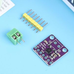

Now it is the time to level up the user experience by providing sound to the project. You will use the MAX98357 I2S Class D Amplifier and connect it to the pi zero according to this Adafruit tutorial. The wiring is:
| Amplifier PIN | Pi zero PIN |
| Vin | 5V Power (pin 1) |
| GND | Ground (pin 6) |
| DIN | GPIO 21 (pin 40) |
| BCLK | GPIO 18 (pin 12) |
| LRC | GPIO 19 (pin 35) |
To install the necessary software, you can try the installer script, provided by the same Adafruit tutorial, which makes it easier to set everything up. When you are ready to test the speaker output and you hear no sound from the speaker, without seeing an error on the console, this means that some extra configuration is missing. I have detailed the steps in this video that I have created, but what you need to do is:
sudo nano /etc/modules
add the following text:
spi-bcm2835
and reboot for changes to take effect. After that you will hear sound from the speaker.
