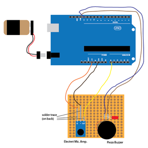

Step 3: Setting the Board and Connecting to Arduino
Now that the code is inputed into the Arduino, we must first:
- close Arduino software
- disconnect the Arduino from the USB cord
- Gather your 5 color-coded wires. Cut them down to at least 6" in length. Strip the ends.

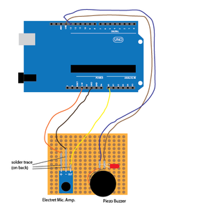

- Insert the 3-pronged Electret Mic into the bare board so that the pins are protruding from the copper side of the board.
- Tin the soldering iron tip by touching it with a strand of solder. Solder the Mic on the three pins in the board.
- On the copper side of the board, drag the tip of the iron onto the board so that the solder will trace the contact points as shown in the image (solder trace).
- Solder the Positive and Ground wires of the Piezo on the other side of the board parallel to the pins of the Mic.
- You can glue the piezo to the board with the glue gun for sturdy support
- Trace the solder on the copper side of the board so that we can ensure connection of the LED and Arduino pins.
- Solder LED onto board
- Solder wires onto board and connect to Arduino pins.
Step 4: Powering the Device
Now that everything is connected, we can power up the Arduino
- connect 9V to pins on barrel jack
- insert into the correct port on the Arduino as shown in the image above

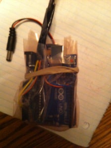

- glue a safety pin onto the back of the perforated board by using the hot glue gun
- take the hot glue gun and dab some glue on each of the pins used on the Arduino. This will ensure that they are less likely to be disconnected from abuse.
- gather all the wires and wrap with electrical tape
- You may put the Arduino board in a static-proof bag if you like (these bags usually come with the purchase of an Arduino). This will make it easier the Arduino to be concealed inside a shirt pocket, etc.

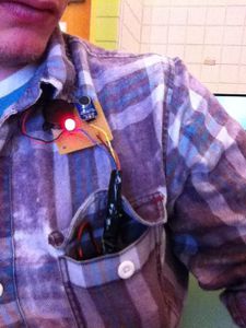

Step 7: Strap It On!
- Put the Arduino inside of a shirt pocket or simply underneath your shirt.
- Have the wires traveling up so that the board with the electret mic is near your neck. Open the safety pin and pin it on your shirt.
- ...you're welcome!
