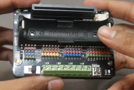

Unscrew the given board from the Expansion board from K10 part.

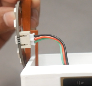

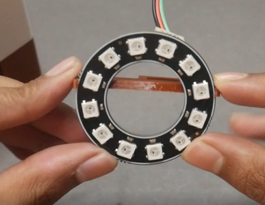

Step 3: Connect the Ring Light
Make sure to connect the Ring Light to pin P0 of the expansion Board
and The cable of the ring Light should be connected to IN of ring light.

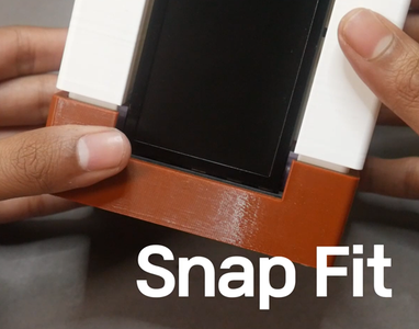

Step 4: Fit Base Board With the Telly Base Part
Step 5: Connect the Battery (OPTIONAL)

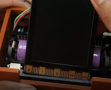

Step 6: Connect the UNIHIKER K10 to Expansion Board
Step 7: Fit the Telly_container Part
Make sure to insert the ring light part into the telly_container part before fitting.
Step 8: Fit the Ring Light
Slide the light_hold part until it tightly fits the ring. Then fit this part on any side of the container.
