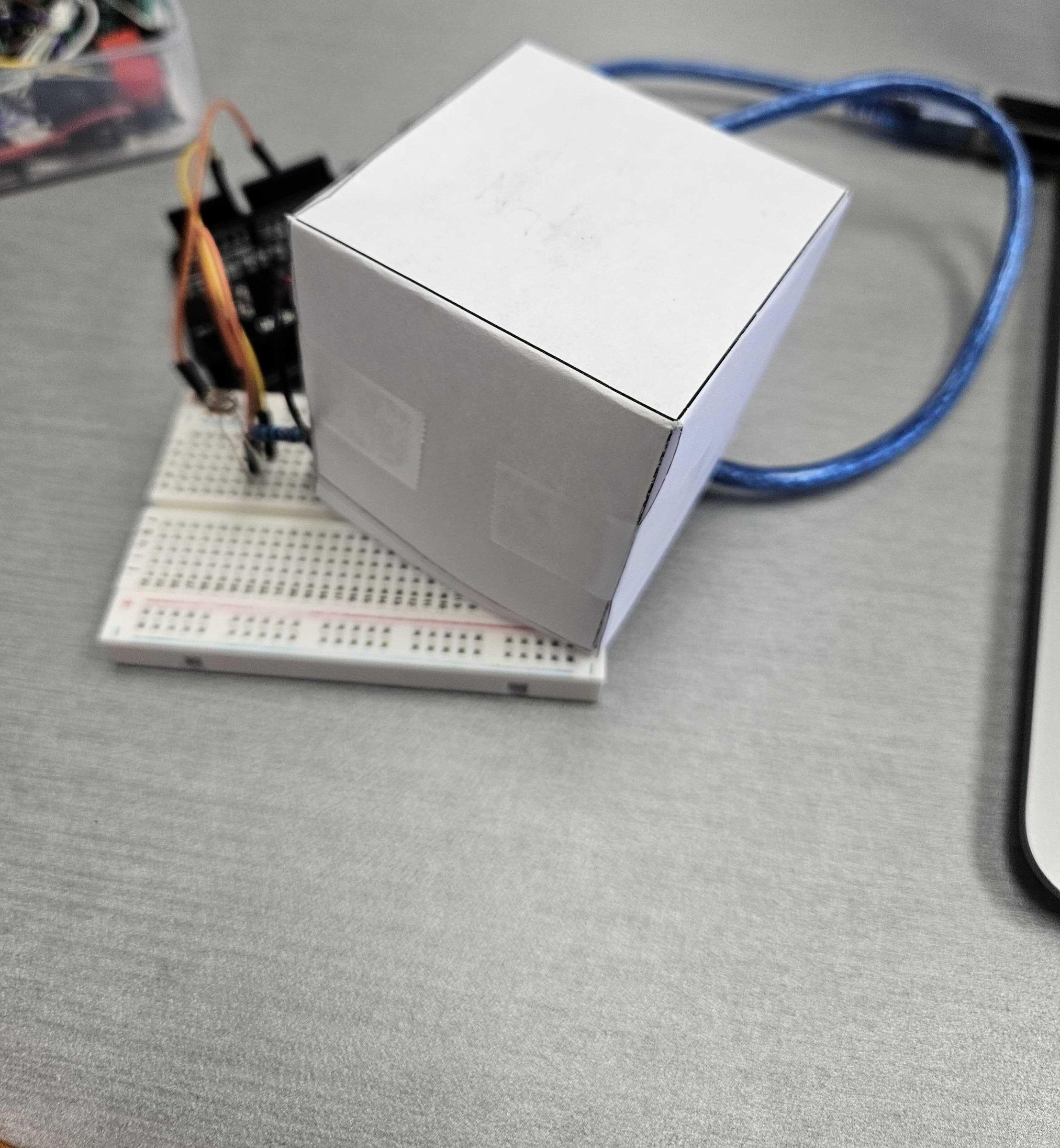

Introduction: Temperature Activated Door Lock
This project monitors temperature using a TMP36 sensor and displays it on a 128x64 OLED screen. If the temperature exceeds 80°F, the system activates a warning system by flashing an LED and sounding a buzzer. Additionally, the lock mechanism (servo motor) will also react to the temperature.

Step 1: Connect the Arduino to the Breadboard
  1. 5V → Bread Board positive strip (+)
  2. GND → Bread Board negative strip (-)
Step 2: Connect the 128x64 OLED Display (I2C)
  1. VCC → 5V
  2. GND → GND
  3. SDA → A4
  4. SCL/SCK → A5
Step 3: Connect the TMP36 Temperature Sensor
  1. VCC → 5V
  2. GND → GND
  3. Vout → A0
Step 4: Connect the LED
  1. LED anode (+) → Digital Pin 13
  2. LED cathode (–) → 220Ω Resistor → GND
Step 5: Connect the Piezo Buzzer
  1. Positive → Digital Pin 12
  2. Negative → GND
Step 6: Connect the Servo Motor
  1. Signal(Yellow) → Digital Pin 7
  2. Power(Red) → 5V
  3. GND(brown or black) → GND

Step 10: Troubleshooting
If the circuit isn't working, try:
  1. Double checking that everything is connected to the correct places.
  2. Double check you've installed all your Libraries.
  3. Adjust the needed temperature for the alarm to activate (like shown in the picture).
