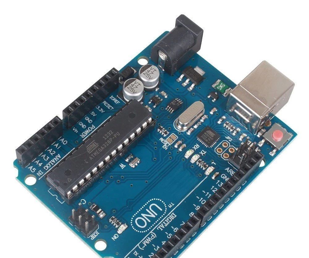

Introduction: Temperature Alarm With Arduino
After experimenting with the LED Real Time Clock shield from PMD Way, I've started to come up with some useful projects that can be demonstrated with it. One example is a temperature alarm - you set a low and high temperature, and if the ambient temperature is below or exceeds the range - the buzzer will sound. .
Once you have the shield, it's very easy to do as everything is assembled. First, install this library into your Arduino IDE. Then plug the shield into your Arduino Uno or compatible board, then upload the sketch below:

Step 1: Operating the Temperature Alarm
Operating instructions:
- To set lower temperature, – press button K2. Blue LED turns on. Use buttons K2 and K1 to select temperature, then press K3 to lock it in. Blue LED turns off.
- To set upper temperature – press button K1. Red LED turns on. Use buttons K2 and K1 to select temperature, then press K3 to lock it in. Red LED turns off.
- If temperature drops below lower or exceeds upper temperature, the blue or red LED will come on.
- You can have the buzzer sound when the alarm activates – to do this, press K3. When the buzzer mode is on, LED D4 will be on. You can turn buzzer off after it activates by pressing K3.
Display will show ambient temperature during normal operation.You can see this in action via the video.
