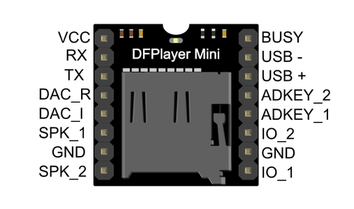

Step 1: Schematic Diagram
The scheme is relatively simple, easy to reconstruct. You can see one of the pins of the MP3 Player connected to the GND. This ensures the maximum volume of the module, if you don't want this, don't connect it (IO_2 pin)
