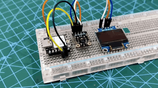

Step 2: Breadboard Version
We first started with a simple breadboard version that included the three main components used, which are the XIAO ESP32C3 board, the SSD1306 screen, and the SHT40 temperature sensor.
  • We added them to a breadboard and first connected the 3V3 pin of XIAO with SHT40's VCC and SSD1306 Screen's VCC port.
  • Next, we connect the GND of XIAO with SHT40 and SSD1306's GND Port.
  • We then add the A4 Pin of XIAO to the SDA pins of SHT40 and SSD1306.
  • At last, we add the A5 Pin of XIAO to the SCK pins of SHT40 and SSD1306.

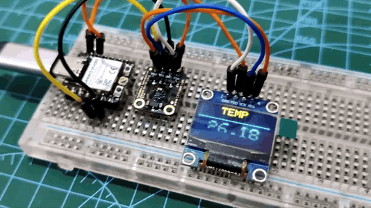

Step 3: CODE
Here's the code that was used in this build, and its a simple one.

This sketch interacts with two sensors: the SHT4x temperature and humidity sensor and the SSD1306 OLED display, and the code essentially reads the temperature from the sensor and displays it on the OLED screen. It could be further extended to include humidity readings or additional functionalities
Make sure to download and install SHT40's Library and SSD1306 Library before uploading this sketch.

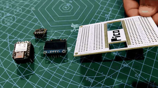

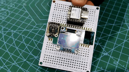

Step 4: LEVEL 2: Assembly

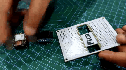

Here is level 2 of this project, which included making a custom circuit board to actually make the device small and useful after working on the breadboard version.
we are using a custom prototyping board, which I made for a previous Raspberry Pi Pico project.
https://www.instructables.com/Raspberry-Pi-Pico-As-HID-Mouse/

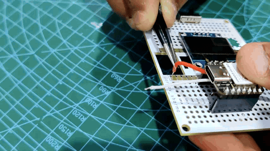

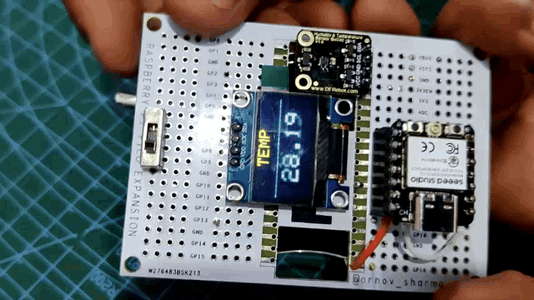

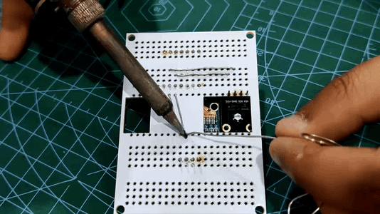

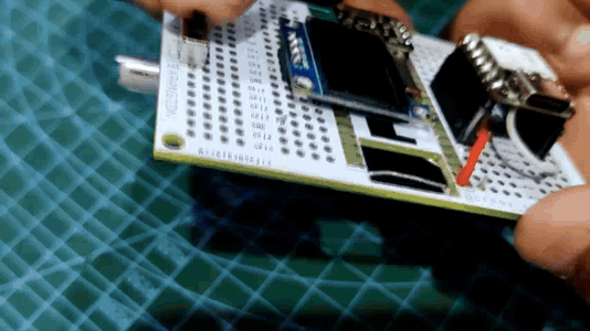

  • We start by first adding all three boards to the prototyping board in the correct order: the SSD1306 display in the middle, the XIAO DEV board on the bottom side, and the SHT40 on the right side next to the SSD1306 display.

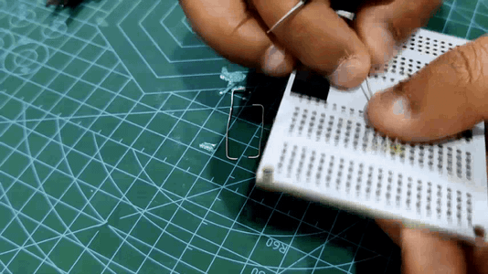

  • Next, we turn the PCB around and solder all the pads of all three boards using a soldering iron.
  • We now make connections, and for that, we are using silver copper wire.
  • Using the same silver copper wire, we connect the VCC of the SHT40 and SSD1306 to XIAO's 3V3 pin. Next, we add the GND of all three together. Finally, we connect XIAO's I2C pins A4 and A5 to the SCL and SDA pins of the SHT40 and SSD1306 modules.

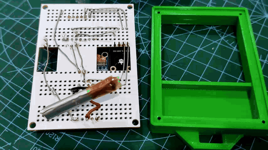

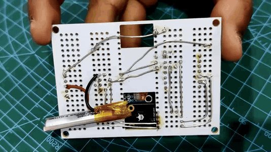

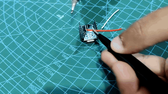

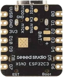

The XIAO ESP32C3 microcontroller has two battery connectors on the back for integrating the battery with the device. It also has an integrated lithium cell charging IC that enables us to attach a small lipo cell to power the entire device.
To pair the LiPo Cell with the Temp Card Setup, we first soldered two wires to XIAO's battery terminals.
Next, we add XIAO to the header pins and connect the previously added two wires to two different solder points on the prototyping board.
Then, we soldered the two wires that were previously added to the battery. In addition, we used a slide switch that is connected to the battery's GND and the negative terminal of the microcontroller's battery terminal. The device can be turned on or off with this switch.

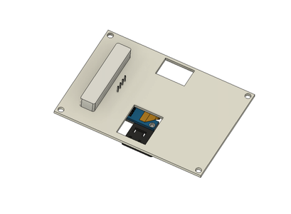

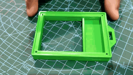

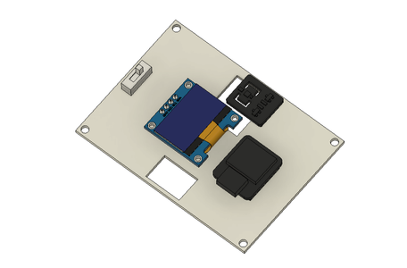

Step 6: 3D Design
In order to create a 3D design, we first use Fusion360 to model the entire circuit board. After that, we build an enclosure to enclose the PCB outline and set the circuit on top of the model. Four mounting holes are created to ensure the circuit stays in place.
For mounting the battery from below, we added a compartment like portion, which keeps the battery intact and secure.
Additionally, we added a slotted part on the top face of the model, which will be used to connect an ID card strap to the body.
Once the design was finished, we exported the mesh file and used a green PLA material to 3D print it using an Ender 3 printer with a 0.4mm nozzle and 25% infill.

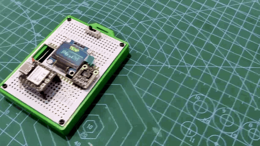

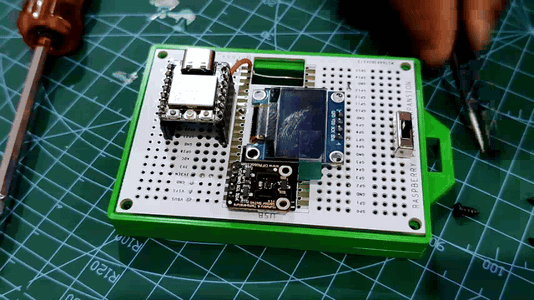

Step 7: FINAL ASSEMBLY
The final assembly was quite easy. We just placed the circuit on top of the 3D printed model and used four M2 screws to firmly attach the enclosure to the entire circuit.

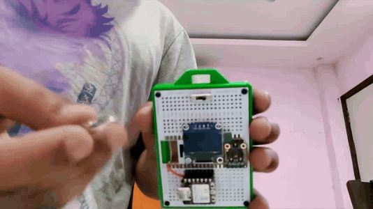

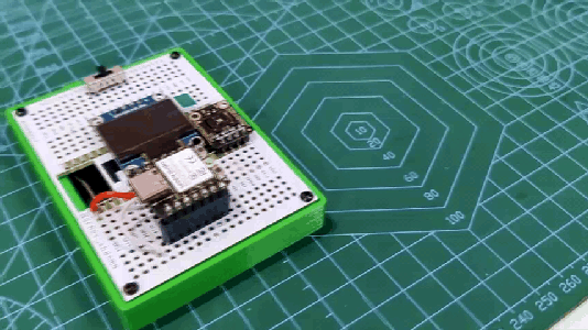

Step 8: RESULT
Here's the result of this simple build: a working temperature meter based around the SHT40 and XIAO ESP32C3 development boards.

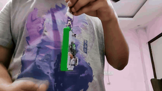

We added an ID card strap to the 3D-printed enclosure, which allows the user to wear this device as a digital ID card that shows temperature readings.
By using the slide switch, the user can turn the device on or off, and portability was possible because of the small LiPo cell that was used to power this device.
