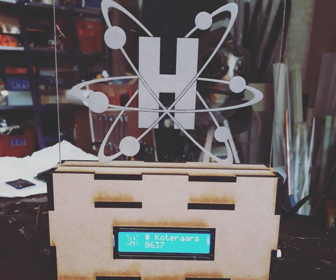

Recently I made a camera stand so I can film my hands while soldering and assembling my project (Instructable of this is coming soon). This is a kick-off project to test the equipment! (And I made it a gift for Henk Rijckaert)
It's a 6cm x 6cm x 6cm cube that changes colors based on the temperature!
