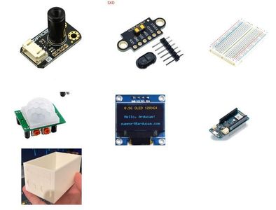

https://eu.mouser.com/ProductDetail/DFRobot/SEN0263?qs=%252BEew9%252B0nqrB%2FzoCKvi5KUA==
https://supergyg.com/index.php?main_page=product_info&products_id=550903
https://www.amazon.com/gp/product/B072Q2X2LL/ref=ppx_yo_dt_b_search_asin_title?ie=UTF8&psc=1
https://www.amazon.com/gp/product/B012ZZ4LPM/ref=ppx_yo_dt_b_search_asin_title?ie=UTF8&psc=1
https://store-usa.arduino.cc/products/arduino-mkr-wifi-1010
https://www.amazon.com/Breadboard-Solderless-Prototype-PCB-Board/dp/B077DN2PS1/ref=sxin_22_ac_d_rm?ac_md=3-3-YnJlYWRib2FyZHMgYXJkdWlubw%3D%3D-ac_d_rm_rm_rm&cv_ct_cx=breadboard&dchild=1&keywords=breadboard&pd_rd_i=B077DN2PS1&pd_rd_r=4f078da9-8d23-4d05-8f11-854eb2419a75&pd_rd_w=4CqY4&pd_rd_wg=lc0tV&pf_rd_p=de2528a5-aaee-45ae-afe7-277ddc135414&pf_rd_r=6DH1DET9VKDHAMCQN3T1&psc=1&qid=1635700793&sr=1-4-12d4272d-8adb-4121-8624-135149aa9081

Step one is to design the concept. Other concepts could be derived from what i did
EDT can work on battery or with USB plug: https://www.arduino.cc/en/Guide/MKRWiFi1010/powering-with-batteries
If EDT is battery powered, saving energy is critical so i put a motion detector. if there is no motion the software and other components do not work. If EDT runs on USB plug then no need to have a motion detector.

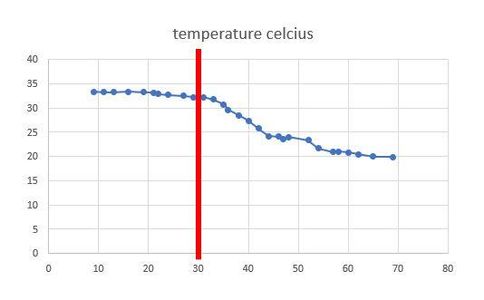

The infrared thermal camera loses precisions as the target measure is further away and that is why I connected a range sensor to measure the distance. The goal is to define the most precise distance at which the measure needs to take place. I took multiple measures and plotted this chart. It is in centimeters for distance horizontally and degree Celsius vertically. What the chart is telling us is that as long as the targeted object is within 30 cm, the readings are accurate enough
for quality control i added a LED screen to plot both distance and temperature and other useful information if needed
finally the led changes color depending on the detected temperature. Right now i have 3 options:
  • green no temperature
  • yellow some temperature
  • red high temperature
you can easily add intermediate options
I selected an Arduino MKR Wifi1010 so i could potentially store all measurements to the cloud and look at trends or even use machine learning algorythms to detect different users.
Finally i also added a buzzer in case you want EDT to work for visually impaired
